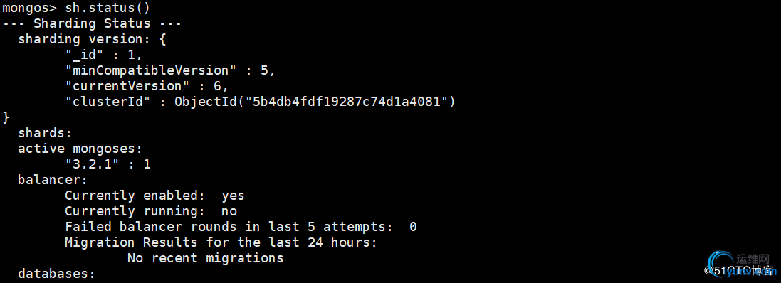

mongos> sh.status()
--- Sharding Status ---
  sharding version: {
  "_id" : 1,
  "minCompatibleVersion" : 5,
  "currentVersion" : 6,
  "clusterId" : ObjectId("5b4db4fdf19287c74d1a4081")
  shards:
  active mongoses:
  "3.2.1" : 1
  balancer:
  Currently enabled:  yes
  Currently running:  no
  Failed balancer rounds in last 5 attempts:  0
  Migration Results for the last 24 hours:
  No recent migrations
  databases:
#可以看到shards下面为空,所以我们需要将两个分片服务器添加进去
