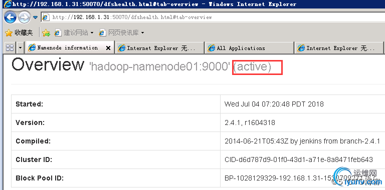

  (12)检查namenode节点角色
  http://192.168.1.31:50070
  说明当前hadoop-namenode01为主节点

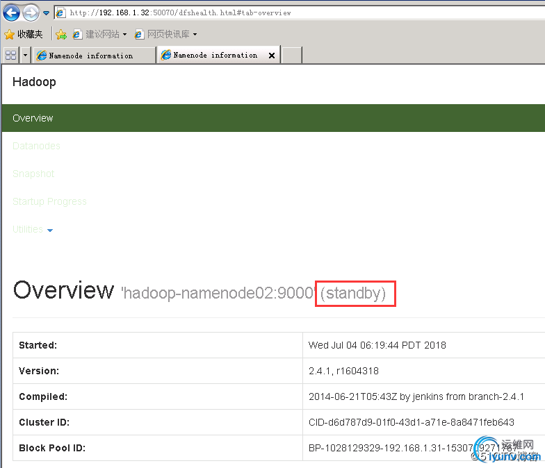

  http://192.168.1.32:50070
  说明hadoop-namenode02为备用节点,状态为standby

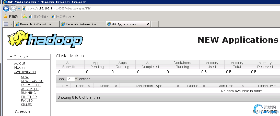

  (14)检查yarn节点角色
  http://192.168.1.41:8088
  说明hadoop-resourcemanager02为active

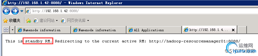

  http://192.168.1.42:8088
  说明hadoop-resourcemanager02为standby

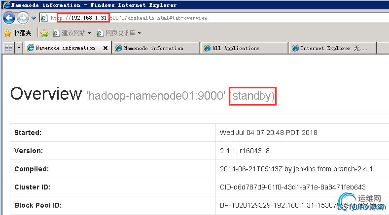

  步骤3:检查192.168.1.32状态
  杀掉192.168.1.31上的namenode进程后,192.168.1.32上namenode变为active状态,故障切换成功。
  步骤4:把192.168.1.31上namenode启动起来
  [root@hadoop-namenode01 sbin]# ./hadoop-daemon.sh start namenode
  [root@hadoop-namenode01 sbin]# jps
  26415 DFSZKFailoverController
  27044 NameNode
  启动之后变为standby
