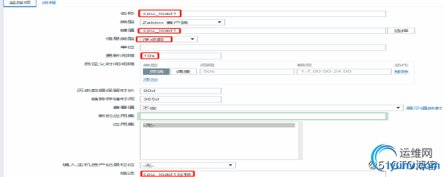

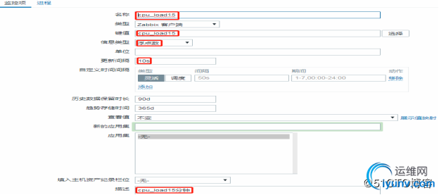

  监控CPU负载
  Agent端:
  [root@zabbix-agent1 ~]# vim /etc/zabbix/zabbix_agentd.conf
  UserParameter=cpu_load1,/usr/bin/w|awk 'NR==1 {print $10}'|awk -F, '{print $1}'
  UserParameter=cpu_load5,/usr/bin/w|awk 'NR==1 {print $11}'|awk -F, '{print $1}'
  UserParameter=cpu_load15,/usr/bin/w|awk 'NR==1 {print $12}'
  Server端:
  [root@zabbix-server ~]# zabbix_get -s 10.0.0.101 -k cpu_load1
  0.00
  [root@zabbix-server ~]# zabbix_get -s 10.0.0.101 -k cpu_load5
  0.01
  [root@zabbix-server ~]# zabbix_get -s 10.0.0.101 -k cpu_load15
  0.05

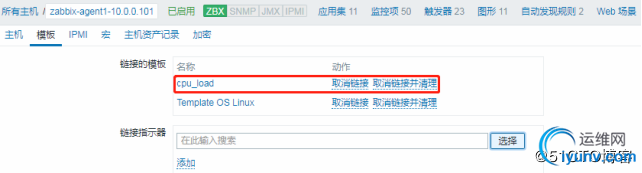

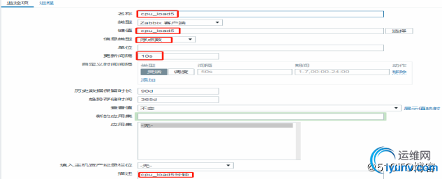

  Step1(配置-->模板-->创建模板):
  Step2(创建克隆监控项):

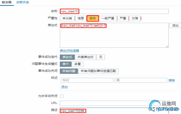

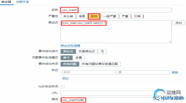

  Step3(创建克隆触发器):

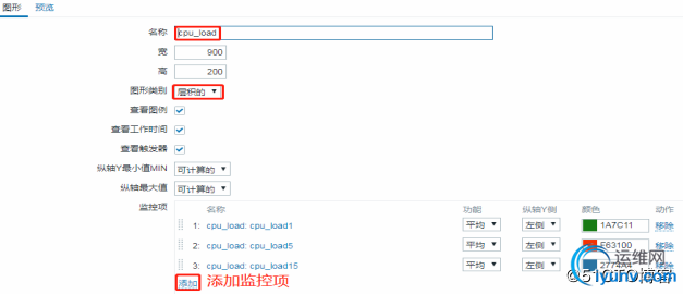

  Step4(创建图形):
  Step5(添加模板如下图):

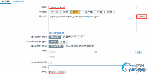

      Server端检测:
      [root@zabbix-server ~]# zabbix_get -s 10.0.0.101 -k nginx_status[accepts]
      177

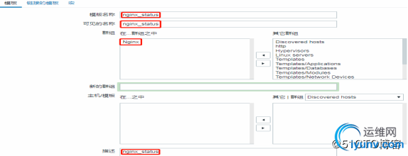

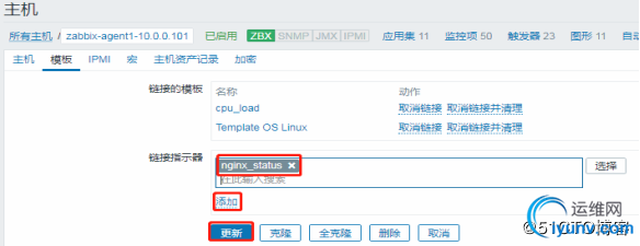

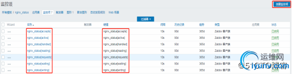

      Step2(添加克隆监控项):

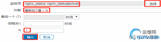

      Step3(添加触发器):
      Add部分

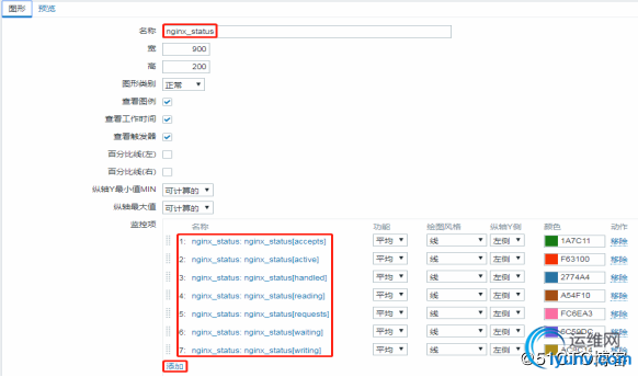

      Step4(添加图形):
      Step5(为主机添加模板):

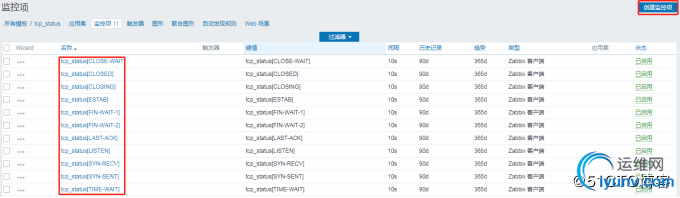

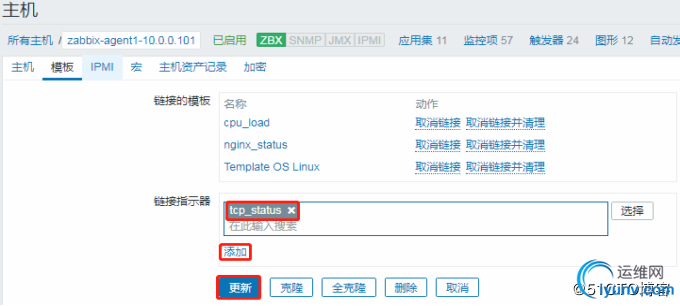

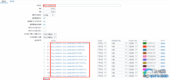

      监控TCP信息状态
      Agent端:
      [root@zabbix-agent1 ~]# cd /etc/zabbix/scripts/
      [root@zabbix-agent1 scripts]#vim tcp_status.sh
      [root@zabbix-agent1 scripts]# chmod +x tcp_status.sh
      [root@zabbix-agent1 scripts]# sh -x tcp_status.sh ESTAB  ##测试脚本
      + '[' 1 -ne 1 ']'
      + tcp_status_fun ESTAB
      + TCP_STAT=ESTAB
      + ss -ant
      + awk 'NR>1 {++s[$1]} END {for(k in s) print k,s[k]}'
      ++ grep ESTAB /tmp/ss.txt
      ++ cut -d ' ' -f2
      + TCP_STAT_VALUE=1
      + '[' -z 1 ']'
      + echo 1
      [root@zabbix-agent1 zabbix_agentd.d]# vim tcp_status.conf
      [root@zabbix-agent1 zabbix_agentd.d]# cat tcp_status.conf
      UserParameter=tcp_status
  • ,/bin/bash /etc/zabbix/scripts/tcp_status.sh "$1"
      [root@zabbix-agent1 zabbix_agentd.d]# systemctl restart zabbix-agent
      Server端
      [root@zabbix-server ~]# zabbix_get -s 10.0.0.101 -k tcp_status[ESTAB] ##出现这种错误到客户端删掉/opt/ss.txt文件
      /etc/zabbix/scripts/tcp_status.sh: line 18: /tmp/ss.txt: Permission denied
      [root@zabbix-server ~]# zabbix_get -s 10.0.0.101 -k tcp_status[ESTAB]  ##检验键值
      Step1(创建模板):
      Step2(创建克隆监控项):
      Step3(创建图形):
      Step4(关联主机):

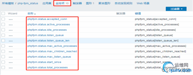

      监控php-fpm状态
      Agent端:
      [root@zabbix-agent1 ~]# yum install -y php php-fpm
      [root@zabbix-agent1 ~]# systemctl start php-fpm
      [root@zabbix-agent1 ~]# netstat -lntup|grep 9000
      tcp      0    0 127.0.0.1:9000   0.0.0.0:*     LISTEN      64086/php-fpm: mast
      [root@zabbix-agent1 ~]# vim /etc/nginx/conf.d/default.conf
      location ~ \.php$ {
      root           /usr/share/nginx/html;
      fastcgi_pass   127.0.0.1:9000;
      fastcgi_index  index.php;
      fastcgi_param  SCRIPT_FILENAME  /usr/share/nginx/html$fastcgi_script_name;
      include        fastcgi_params;
      [root@zabbix-agent1 ~]# vim /usr/share/nginx/html/index.php
      浏览器http://10.0.0.101/index.php能否成功
      [root@zabbix-agent1 ~]# vim /etc/php-fpm.d/www.conf
      pm.status_path = /phpfpm_status
      [root@zabbix-agent1 ~]# systemctl restart php-fpm
      location ~ ^/(phpfpm_status)$ {
      fastcgi_param SCRIPT_FILENAME $document_root$fastcgi_script_name;
      [root@zabbix-agent1 ~]# nginx -t
      nginx: the configuration file /etc/nginx/nginx.conf syntax is ok
      nginx: configuration file /etc/nginx/nginx.conf test is successful
      [root@zabbix-agent1 ~]# nginx -s>  浏览器http://10.0.0.101/phpfpm_status或者curl http://10.0.0.101/phpfpm_status
      [root@zabbix-agent1 ~]# curl  http://10.0.0.101/phpfpm_status
      pool:                 www
      process manager:      dynamic
      start time:          16/May/2018:19:33:39 +0800
      start since:         462
      accepted conn:       7
      listen queue:        0
      max listen queue:     0
      listen queue len:     128
      idle processes:       4
      active processes:     1
      total processes:      5
      max active processes: 1
      max children reached: 0
      slow requests:        0
      [root@zabbix-agent1 ~]# curl -s http://10.0.0.101/phpfpm_status|awk '/accepted conn:/ {print $NF}'
      [root@zabbix-agent1 scripts]# vim phpfpm_status.sh
      [root@zabbix-agent1 scripts]# chmod +x phpfpm_status.sh
      [root@zabbix-agent1 scripts]# cd ..
      [root@zabbix-agent1 zabbix]# cd zabbix_agentd.d/
      [root@zabbix-agent1 zabbix_agentd.d]# vim phpfpm_status.conf
      UserParameter=phpfpm_status
  • ,/bin/bash /etc/zabbix/scripts/phpfpm_status.sh "$1"
      [root@zabbix-agent1 ~]# systemctl restart zabbix-agent
      Server端:
      [root@zabbix-server zabbix]# zabbix_get -s 10.0.0.101 -k phpfpm_status[accepted_conn]
      20

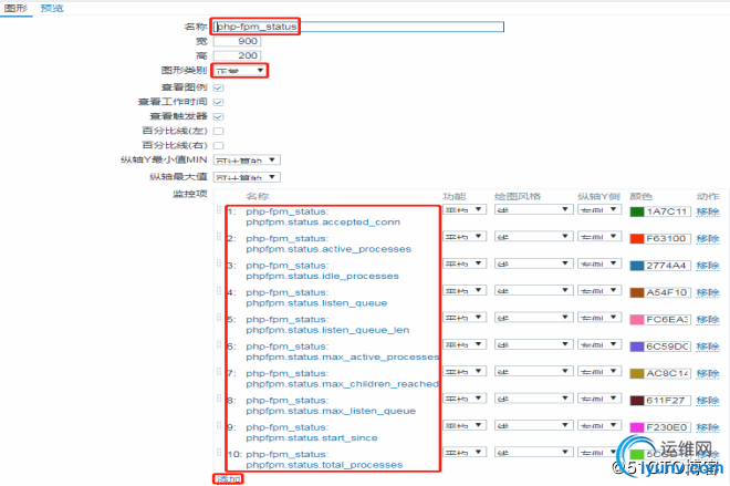

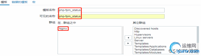

      Step1(创建模板):
      Step2(关联主机):

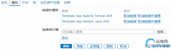

      Zabbix-java-gateway端:
      [root@zabbix-agent1 ~]# yum install -y zabbix-java-gateway java-1.8.0-openjdk
      [root@zabbix-agent1 ~]# systemctl start zabbix-java-gateway
      [root@zabbix-agent1 ~]# netstat -lntup|grep java
      tcp6       0      0 :::10052       :::*        LISTEN      6934/java
      Zabbix-Server端:
      [root@zabbix-server ~]# vim /etc/zabbix/zabbix_server.conf
      JavaGateway=10.0.0.101
      StartJavaPollers=5
      [root@zabbix-server ~]# systemctl restart zabbix-server

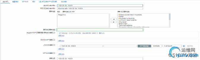

      Step1(配置-->主机-->创建主机):
      Step2(添加主机-->添加模板):
      Step3:
