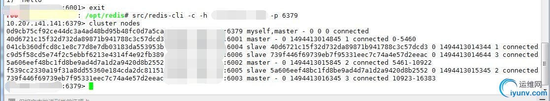

  root@redis: /opt/redis# src/redis-cli -c -h 10.10.101.100 -p 6379
  10.10.101.100:6379> cluster nodes
  0d9cb75cf92ce44dc3a4ad48bd95b48fc0d7a5ca 10.10.101.100:6379 myself,master - 0 0 0 connected
  40d6721c15f32d732da89871b941788c3c57dcd3 10.10.101.100:6001 master - 0 1494413014845 1 connected 0-5460
  041cb360dfcd8c1e8c77d8e7db03183da553953b 10.10.101.100:6004 slave 40d6721c15f32d732da89871b941788c3c57dcd3 0 1494413014344 1 connected
  c9d5f58cd5e74f2c5ebbf6213e4314f4e92fb389 10.10.101.100:6006 slave 739f446f69739eb7f95331eec7c74a4e57d2eeac 0 1494413014644 3 connected
  5a606eef48bc1fd8be9ad4d7a1d2a9420d8b2552 10.10.101.100:6002 master - 0 1494413015845 2 connected 5461-10922
  f539cc2330a19f31a8dd55360e184cda2dc81151 10.10.101.100:6005 slave 5a606eef48bc1fd8be9ad4d7a1d2a9420d8b2552 0 1494413015345 2 connected
  739f446f69739eb7f95331eec7c74a4e57d2eeac 10.10.101.100:6003 master - 0 1494413016345 3 connected 10923-16383
  10.10.101.100:6379>
  // 新节点没有包含任何数据, 因为它没有包含任何哈希槽.
  尽管新节点没有包含任何哈希槽, 但它仍然是一个主节点, 所以在集群需要将某个从节点升级为新的主节点时, 这个新节点不会被选中。只要将集群中的某些哈希桶移动到新节点里面, 新节点就会成为真正的主节点了。
