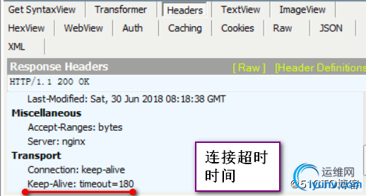

连接超时
[root@localhost nginx]# vim /usr/local/nginx/conf/nginx.conf
... ... 省略
  #keepalive_timeout  0;
  keepalive_timeout  65;   //删除此行,并在下面添加
  keepalive_timeout  65 180;
  client_header_timeout 80;
  client_body_timeout 80;
[root@localhost nginx]# nginx -t   //检查语法
[root@localhost nginx]# service nginx stop
[root@localhost nginx]# service nginx start   //重启nginxfuwu
  然后此时同样使用装有一台安装了fiddler工具的win7客户机去访问nginx服务器
