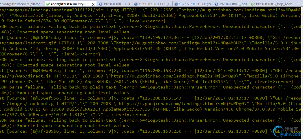

  4,测试下脚步是否成功并启动该服务,服务启动后会一直刷日志。
[root@ittestserver1 log]# /usr/local/logstash/bin/logstash -t -f /usr/local/logstash/etc/nginx-access0518.conf
Configuration OK
[root@ittestserver1 log]# /usr/local/logstash/bin/logstash  -f /usr/local/logstash/etc/nginx-access0518.conf
nux; Android 5.1.1; R7Plusm Build/LMY47V) AppleWebKit/537.36 (KHTML, like Gecko) Version/4.0 Chrome/37.0.0.0 Mobile MQQBrowser/6.9 TBS/036906 Safari/537.36 hsp\" \"-\"", :level=>:error}
JSON parse failure. Falling back to plain-text {:error=>#, :data=>"175.155.181.151 - - [12/Jan/2017:01:28:05 +0800] \"GET /resources/images/m/landing/landingm20161221/header.png HTTP/1.1\" 200 233816 \"https://m.guojinbao.com/landingm.html?s=NDg4MDU2\" \"Mozilla/5.0 (iPhone; CPU iPhone OS 9_1 like Mac OS X) AppleWebKit/601.1.46 (KHTML, like Gecko) Mobile/13B143\" \"-\"", :level=>:error}
JSON parse failure. Falling back to plain-text {:error=>#, :data=>"223.67.223.215 - - [12/Jan/2017:01:28:05 +0800] \"GET /resources/js/Crypto.js HTTP/1.1\" 200 8703 \"https://m.guojinbao.com/landingm.html?s=MzIxODQ=\" \"Mozilla/5.0 (Linux; Android 5.1.1; R7Plusm Build/LMY47V) AppleWebKit/537.36 (KHTML, like Gecko) Version/4.0 Chrome/37.0.0.0 Mobile MQQBrowser/6.9 TBS/036906 Safari/537.36 hsp\" \"-\"", :level=>:error}
JSON parse failure. Falling back to plain-text {:error=>#, :data=>"223.67.223.215 - - [12/Jan/2017:01:28:05 +0800] \"GET /resources/images/m/landing/landingm20161221/btn1.png HTTP/1.1\" 200 10194 \"https://m.guojinbao.com/resources/css/landingm20161221.css\" \"Mozilla/5.0 (Linux; Android 5.1.1; R7Plusm Build/LMY47V) AppleWebKit/537.36 (KHTML, like Gecko) Version/4.0 Chrome/37.0.0.0 Mobile MQQBrowser/6.9 TBS/036906

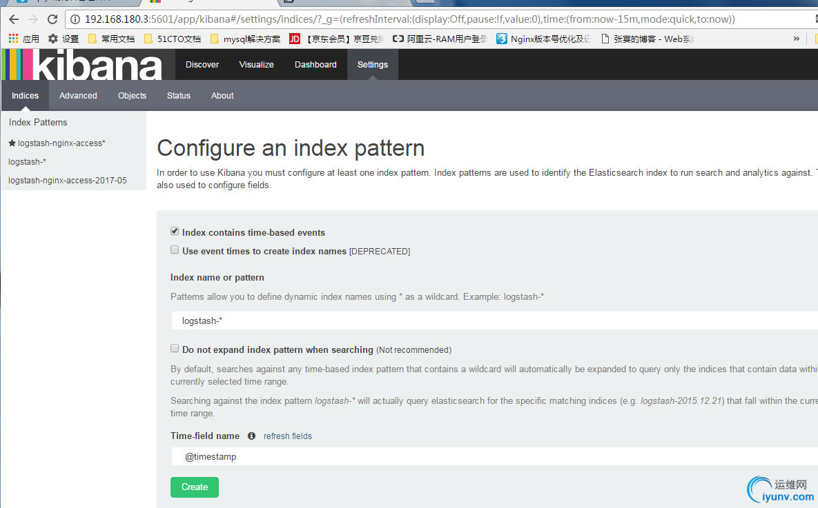

  (三)kibana配置
  (1)登录192.168.180.3:5601登录kibana
  (2),添加一个索引,这个索引的名字就是之前导入的ES中的那个,本文中是logstash-nginx-access-*。
  查看索引,目前有三个,设置为加星,即是discover默认突出显示的。
