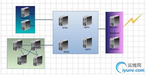

实验拓扑:
实验环境:

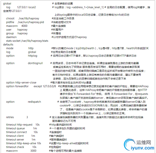

  vi /etc/haproxy/haproxy.cfg
  global
  log 127.0.0.1   local0
  log 127.0.0.1   local1 notice
  #log loghost    local0 info
  maxconn 4096
  uid 99
  gid 99
  daemon
  #debug
  #quiet
  defaults
  log     global
  mode    http
  option  httplog
  option  dontlognull
  retries 3
  maxconn 2000
  contimeout      5000
  clitimeout      50000
  srvtimeout      50000
  frontend http            ##定义名称为http
  bind *:80           ##指定监听地址
  acl linuxfan hdr_end(host) -i www.linuxfan.cn         ###定义acl名称为linuxfan:访问www.linuxfan.cn这个域名
  acl static path_end -i .html .css .js .png .jpg .jpeg .gif .ico .swf.xml .txt .pdf           ##定义acl名称为static:访问url为以上后缀的页面
  use_backend jingtai if static or linuxfan            ##定义使用banckend:符合linuxfan和static两条acl的请求使用backend jingtai
  default_backend dongtai         ##默认的请求使用backenddongtai
  backend jingtai         ##定义backend :jingtai
  mode http        ##定义模式
  balance roundrobin          ##定义调度算法为轮询
  server jingtai01 192.168.100.152:80 check inter 2000 fall 3           ##定义节点
  server jingtai01 192.168.100.153:80 check inter 2000 fall 3
  backend dongtai
  mode http
  balance roundrobin
  server dongtai01 192.168.100.150:80 check inter 2000 fall 3
  server dongtai01 192.168.100.151:80 check inter 2000 fall 3
  :wq

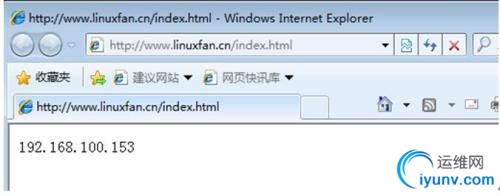

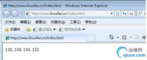

  9.客户端访问测试:

  haproxy的配置文件详解:
  http://blog.csdn.net/tantexian/article/details/50056199      负载均衡haproxy配置
