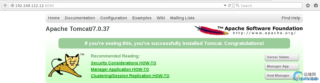

  [root@server2 tomcat]# bin/startup.sh       开启tomcat,端口默认为8080
  [root@server2 tomcat]# netstat -antlp

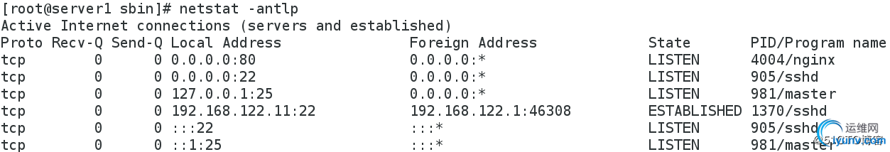

  [root@server1 sbin]# cd  /usr/sbin

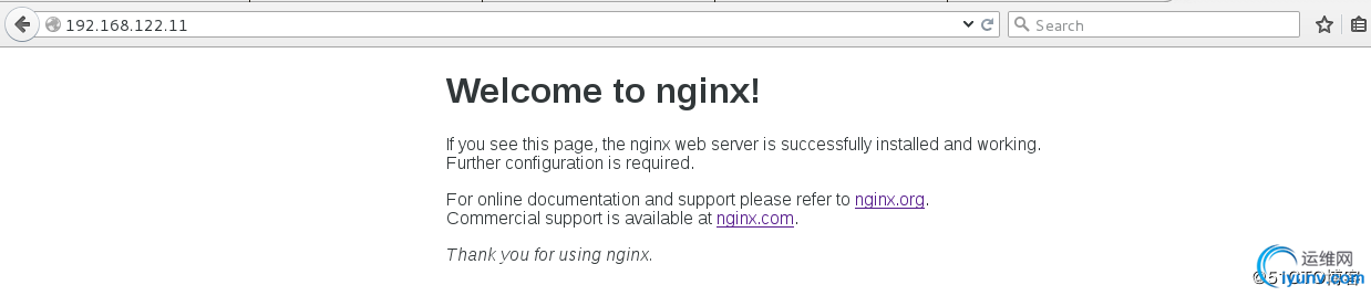

  [root@server1 sbin]# nginx     开启nginx

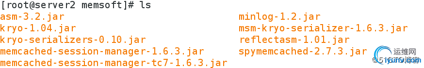

  把如下软件包放置到/usr/local/tomcat/lib 目录中
  kryo-1.03.jar
  kryo-serializers-0.8.jar
  memcached-2.5.jar
  memcached-session-manager-1.5.1.jarmemcached-session-manager-tc7-1.5.1.jar
  minlog-1.2.jar
  msm-kryo-serializer-1.5.1.jar
  reflectasm-0.9.jar
  [root@server2 memsoft]# mv * /usr/local/tomcat/lib/
