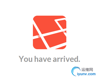

sudo chmod -R 775 /var/www/html/laravel/app/storage  You now have Laravel completely installed and ready to
go.  You can see the default landing page by visiting your server's
domain or IP address in your web browser:
http://server_domain_or_IP
  You now have everything you need to start building applications with the Laravel framework.
