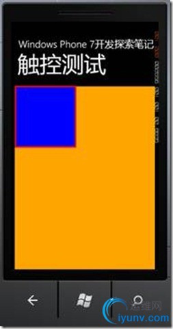

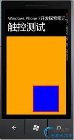

  在接下来的文章中我会通过一个例子介绍所有与Manipulation事件相关的内容。首先来看一下程序的Logic Tree和效果图:

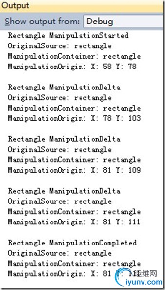

  下面的代码演示了这3个事件中相同的属性:
代码
        void rectangle_ManipulationStarted(object sender, ManipulationStartedEventArgs e)
            Debug.WriteLine("Rectangle ManipulationStarted");
            Debug.WriteLine("OriginalSource: " + (e.OriginalSource as FrameworkElement).Name);
            Debug.WriteLine("ManipulationContainer: " + (e.ManipulationContainer as FrameworkElement).Name);
            Debug.WriteLine("ManipulationOrigin: " + "X: " + e.ManipulationOrigin.X.ToString() + " Y: " + e.ManipulationOrigin.Y.ToString() + "\n");
        void rectangle_ManipulationDelta(object sender, ManipulationDeltaEventArgs e)
            Debug.WriteLine("Rectangle ManipulationDelta");
        void rectangle_ManipulationCompleted(object sender, ManipulationCompletedEventArgs e)
            Debug.WriteLine("Rectangle ManipulationCompleted");
        }  下面是输出结果:
  和上面说过的顺序一样。此次操作触发了3次ManipulationDelta事件,由于手指(这里是鼠标,因为是在模拟器上操作的)在屏幕上移动了,所以每次的ManipulationOrigin值都是不一样的。同时我们还可以看到OriginalSource和ManipulationContainer是相同的。

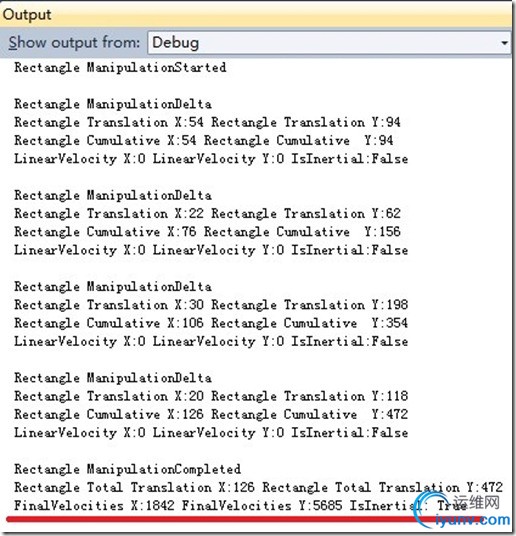

  我在上述程序中的Rectangle元素的RenderTransform属性中添加了一个TranslateTransform变换。并在这个Rectangle元素的ManipulationDelta事件处理程序中对TranslateTransform进行了操作,使得这个矩形可以在屏幕上移动,同时将所能获取到的信息输出到Output窗口,下面是代码:
代码
            Debug.WriteLine("Rectangle ManipulationStarted\n");
            this.translation.X += e.DeltaManipulation.Translation.X;
            this.translation.Y += e.DeltaManipulation.Translation.Y;
            Debug.WriteLine("Rectangle Translation X:" + e.DeltaManipulation.Translation.X + " Rectangle Translation Y:" + e.DeltaManipulation.Translation.Y);
            Debug.WriteLine("Rectangle Cumulative X:" + e.CumulativeManipulation.Translation.X + " Rectangle Cumulative  Y:" + e.CumulativeManipulation.Translation.Y);
            Debug.WriteLine("LinearVelocity X:" + e.Velocities.LinearVelocity.X + " LinearVelocity Y:" + e.Velocities.LinearVelocity.Y + " IsInertial:" + e.IsInertial + "\n");
            Debug.WriteLine("Rectangle Total Translation X:" + e.TotalManipulation.Translation.X + " Rectangle Total Translation Y:" + e.TotalManipulation.Translation.Y);
            Debug.WriteLine("FinalVelocities X:" + e.FinalVelocities.LinearVelocity.X + " FinalVelocities Y:" + e.FinalVelocities.LinearVelocity.Y + " IsInertial: " + e.IsInertial + "\n");
        }  在上面代码的rectangle_ManipulationDelta方法中,我分别将Translation的X和Y赋给了TranslateTransform变换的X和Y,以保证矩形可以随意移动。下面是模拟器和输出窗口的截图:
  注意上图中ManipulationCompleted事件参数中的FinalVelocities数值很大,这是因为我当时移动矩形的速度非常快,如果是很慢的移动它,那么这个数值将变为0,同时IsInertial属性为False。另外,如果在ManipulationDelta的事件处理程序中调用了事件参数的Complete方法,则移动矩形时只能一下一下地移动,因为只会触发一次ManipulationDelta事件,并且ManipulationCompleted事件参数中的FinalVelocities属性会抛出NullReferenceException异常。
