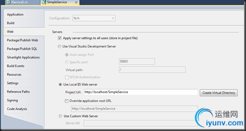

public interface IService1 {         [OperationContract]    string GetData(int value);}   Note I: I’ve created this service in a new solution in an instance of Visual Studio 2010 running as administrator. I did this because I wanted to run the service in IIS so that it can be accessed from multiple computers (so that the iphone/simulator on my Mac can access it). See the following image to configure the service to run on IIS.
  Note II: Because I’m running this service in IIS 7 with .NET 4 there is almost no configuration for this service in the web.config file. What this does mean is that because I’m publishing this service over HTTP the default binding is the basicHttpBinding. As with Silverlight and the .NET Compact Framework, there is only support for basicHttpBinding (or the webHttpBinding if you want to roll your own web requests).

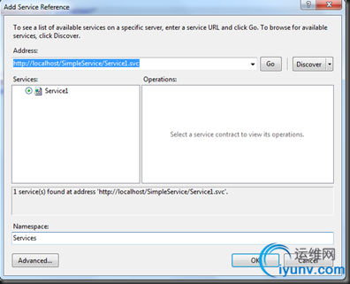

  - Enter the address of the wcf service (eg http://localhost/SimpleService/Service1.svc” and hit Go. This should return the service information. Give it a namespace (eg Services) and click OK.
  This will generate a folder called Service References, a number of files that contain the proxy classes for the referenced service and a ServiceReferences.ClientConfig file, which includes endpoint configuration information about the service.

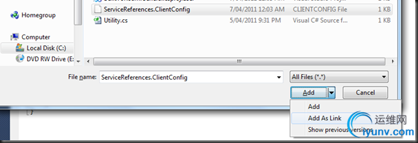

  - Right-Click the WP7 application project node (ie BuiltToRoam) and select Add >Existing Item. Navigate to the shared library (ie BuiltToRoam.General) and select the ServiceReferences.ClientConfig file. Do NOT click the centre of the Add button. Instead click the down arrow on the right side of the Add button. Then select Add as Link.
  Note: This is important because if we update the service reference in the future we don’t want to have to remember to update additional copies of this file.
