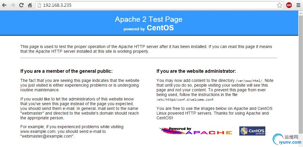

iptables-save > /etc/sysconfig/iptablesNow we can open our local web browser and enter the IP address of your Zabbix server. The Apache landing page should appear.

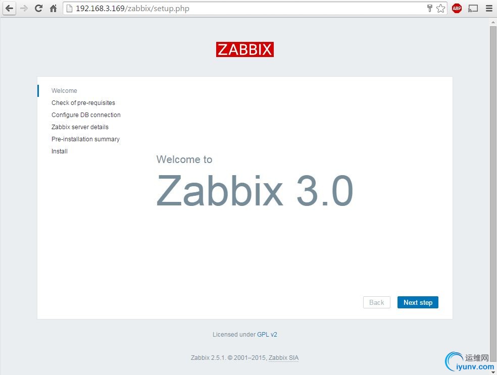

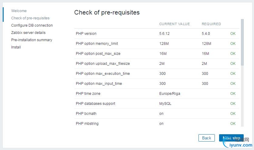

service zabbix_agentd startFinally it is time to proceed to the frontend installation in your web browser.
Use the same address you have for your server now and add /zabbix to the URL.
Check for pre-requisites and fix errors if you have any.

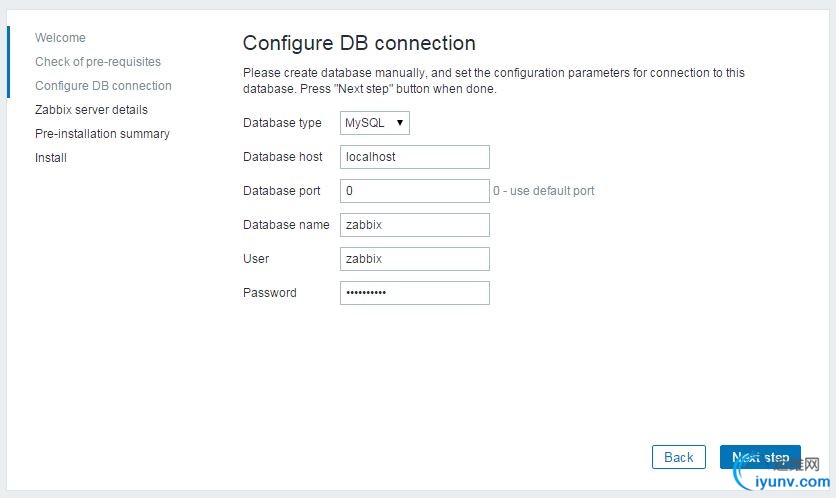

Enter settings to connect to database.

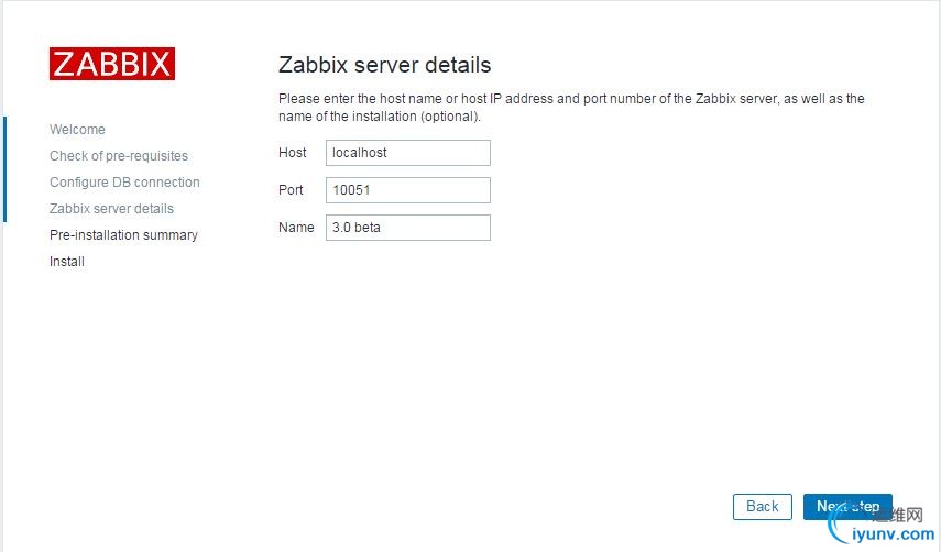

Enter details to connect to web interface.
The “Name” field can be left blank or you can enter a name that will appear on each page.

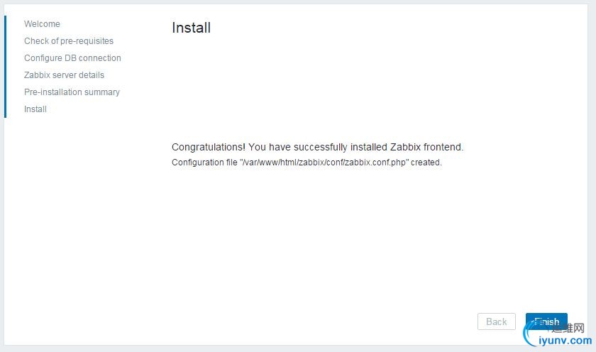

Review the last settings in the next page and if all is good your Zabbix should be able to automatically create configuration files.

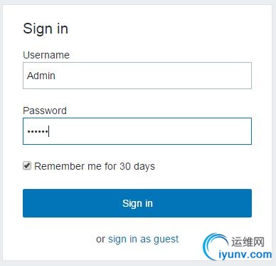

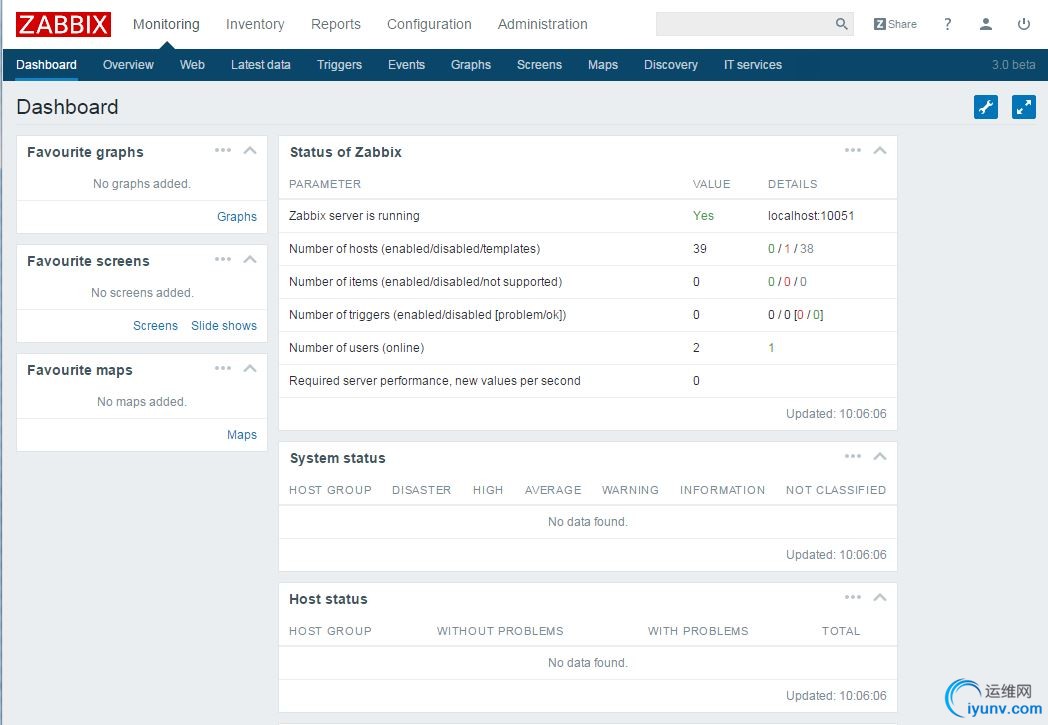

Connect to the Zabbix web interface with default credentials.
Username: AdminPassword: zabbix DSC0006.jpg
And this is the new web interface.
Congratulations! You have installed the new Zabbix 3.0. Have fun! Don’t forget to check our documentation for 3.0. And stay tuned for next tutorials and articles where we will cover the main features of Zabbix 3.0 and do lots of useful configuration.
