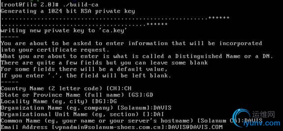

  ./clean-all
  ./build-ca

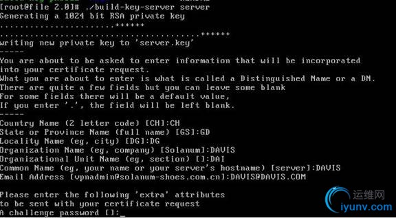

  ./build-key-server server
