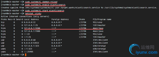

  Reload systemd, enable Elasticsearch to start at boot time, then start the service.
  sudo systemctl daemon-reload
  sudo systemctl enable elasticsearch
  sudo systemctl start elasticsearch
  Wait a second for Eelasticsearch to start, then check the open ports on the server, make sure 'state' for port 9200 is 'LISTEN'.
  netstat -plntu

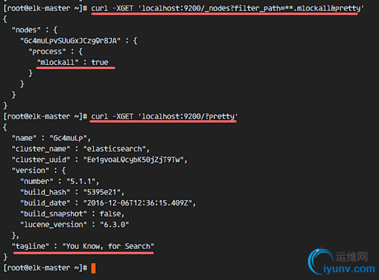

  Then check the memory lock to ensure that mlockall is enabled, and check that Elasticsearch is running with the commands below.
  curl -XGET 'localhost:9200/_nodes?filter_path=**.mlockall&pretty'
  curl -XGET 'localhost:9200/?pretty'
  You will see the results below.

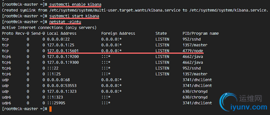

  Add Kibana to run at boot and start it.
  sudo systemctl enable kibana
  sudo systemctl start kibana
  Kibana will run on port 5601 as node application.
  netstat -plntu

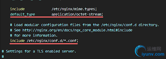

  Edit the Nginx configuration file and remove the 'server { }' block, so we can add a new virtual host configuration.
  cd /etc/nginx/
  vim nginx.conf
  Remove the server { } block.
  Save the file and exit vim.

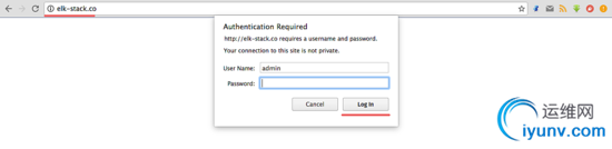

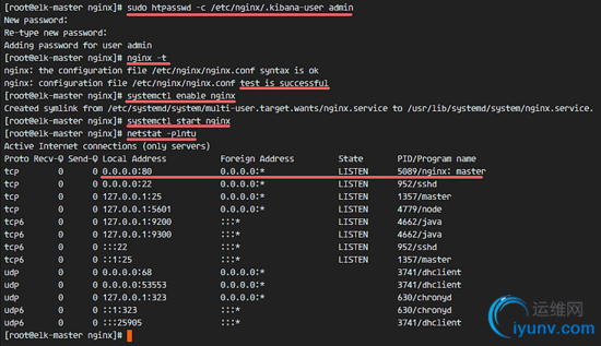

  Then create a new basic authentication file with the htpasswd command.
  sudo htpasswd -c /etc/nginx/.kibana-user admin
  TYPE YOUR PASSWORD
  Test the Nginx configuration and make sure there is no error. Then add Nginx to run at the boot time and start Nginx.
  nginx -t
  systemctl enable nginx
  systemctl start nginx

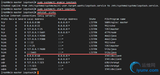

  Finally add logstash to start at boot time and start the service.
  sudo systemctl enable logstash
  sudo systemctl start logstash

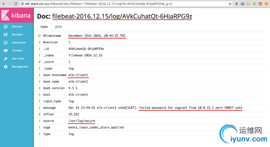

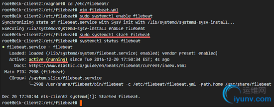

  Add Filebeat to start at boot time and start it.
  sudo systemctl enable filebeat
  sudo systemctl start filebeat

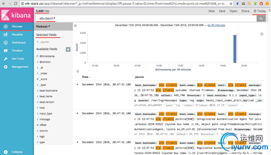

Step 7 - Install and Configure Filebeat on the Ubuntu Client
  Connect to the server by ssh.
  ssh root@ubuntu-clientIP

  Go to the filebeat configuration directory and edit the file 'filebeat.yml' with vim.
  cd /etc/filebeat/
  vim filebeat.yml
  Add the new log file paths in the paths configuration section.
  paths:
  - /var/log/auth.log
  - /var/log/syslog
  Set the document type to syslog.
  document-type: syslog
  Disable elasticsearch output by adding comments to the lines shown below.
  #-------------------------- Elasticsearch output ------------------------------
  #output.elasticsearch:
  # Array of hosts to connect to.
  #  hosts: ["localhost:9200"]
  Enable logstash output, uncomment the configuration and change the values as shown below.
  output.logstash:
  # The Logstash hosts
  hosts: ["10.0.15.10:5443"]
  bulk_max_size: 1024
  ssl.certificate_authorities: ["/etc/pki/tls/certs/logstash-forwarder.crt"]
  template.name: "filebeat"
  template.path: "filebeat.template.json"
  template.overwrite: false
  Check the service status.
  systemctl status filebeat

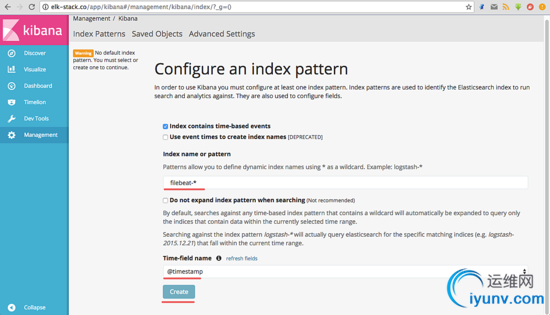

  Open your web browser and visit the elastic stack domain that you used in the Nginx configuration,  mine is 'elk-stack.co'. Login as admin user with your password and press Enter to log in to the Kibana dashboard.
  Create a new default index 'filebeat-*' and click on the 'Create' button.
  Th default index has been created. If you have multiple beats on the elastic stack, you can configure the default beat with just one click on the 'star' button.

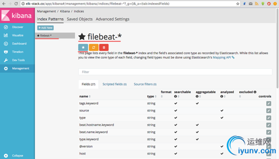

  Go to the 'Discover' menu and you will see all the log file from the elk-client1 and elk-client2 servers.
  An example of JSON output from the elk-client1 server log for an invalid ssh login.
  And there is much more than you can do with Kibana dashboard, just play around with the available options.
