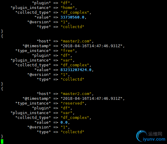

[root@master2 ~]# systemctl start collectd.service
logstash端配置:
[root@master1 ~]# vim /etc/logstash/conf.d/udpsample.conf
input {
udp {
port    => 25826
codec   => collectd {}
type    => "collectd"
output {
stdout {
codec   => rubydebug
语法检测:
[root@master1 ~]# logstash -f /etc/logstash/conf.d/udpsample.conf --configtest
Configuration OK
启动:
Logstash startup completed
