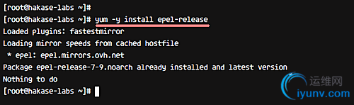

  In this step, we will install the Nginx web server from the EPEL (Extra Packages for Enterprise Linux) repository. Before installing Nginx, make sure the EPEL repository has been installed on your server.
  If you do not have it, you can install it using the command below.
  yum -y install epel-release

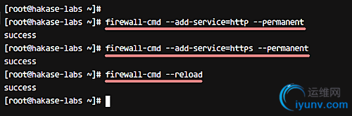

  After the installation, open HTTP and HTTPS ports using the firewall-cmd command below.
  firewall-cmd --add-service=http --permanent
  firewall-cmd --add-service=https --permanent
  firewall-cmd --reload

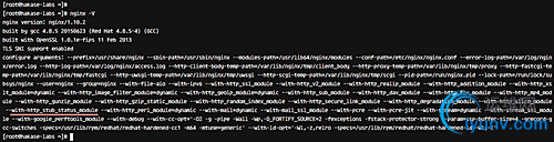

  To monitor Nginx using Netdata, we must enable the 'stub_status' module by editing the configuration. Make sure your Nginx version has a module named 'stub_status', check the module with the command below.
  nginx -V
  You should get a result similar to the following.
  Make sure you have the 'stub_status' module on the list.

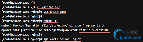

  Next, edit the nginx configuration file 'nginx.conf' to enable the 'stub_status' module. Go to the '/etc/nginx/' directory and edit the configuration with vim.
  cd /etc/nginx/
  vim nginx.conf

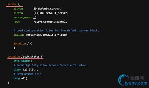

  Paste the following configuration inside the 'server {}' block.
    location /stub_status {
         stub_status;
         # Security: Only allow access from the IP below.
         allow 127.0.0.1;
         # Deny anyone else
         deny all;
  Save and exit.
  Now, test the nginx configuration and make sure there is no error. Then restart nginx.
  nginx -t
  systemctl restart nginx

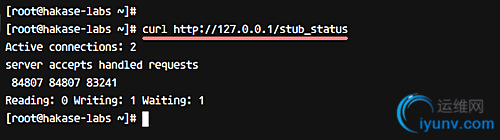

  Nginx 'stub_status' module has been enabled - we can check it using the curl command as shown below.
  curl http://127.0.0.1/stub_status
  When it's enabled, you can see the result as below.

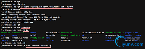

  Next, download Netdata source code using the following git command.
  cd ~
  git clone https://github.com/firehol/netdata.git --depth=1

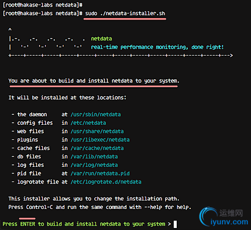

  Go to the netdata directory and run the Netdata installer script with sudo privileges.
  cd netdata/
  sudo ./netdata-installer.sh
  Press 'Enter' to continue with the Nedata installation.

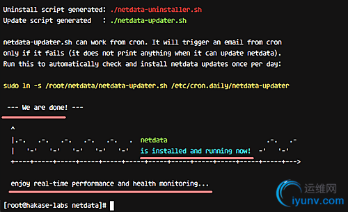

  And when the installation is complete, you will see the result as below.

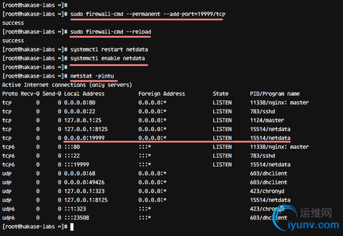

  Netdata has been installation on CentOS 7, and it's running on port '19999'.
  Open the port using the firewall-cmd command below.
  sudo firewall-cmd --permanent --add-port=19999/tcp
  sudo firewall-cmd --reload
  Netdata provides a systemd services script, so you can manage Netdata using the systemctl command. Restart netdata and enable it to launch automatically every time at system boot.
  systemctl restart netdata
  systemctl enable netdata
  Check the opened port of the server - make sure you get the port 19999 on the 'LISTEN' state.
  netstat -plntu

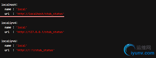

  Go to the netdata 'python.d' directory and edit the configuration file nginx.conf using vim.
  cd /etc/netdata/python.d/
  vim nginx.conf
  Go to the bottom line and make sure you have a configuration as shown below.
localhost:
   url  : 'http://localhost/stub_status'
  Save and exit.

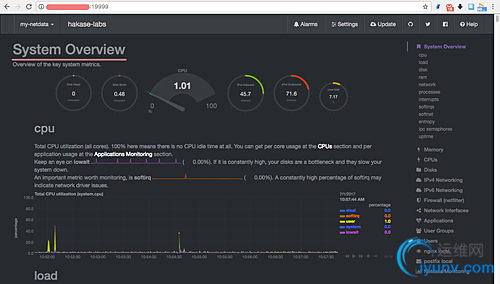

  Open your web browser and visit the server IP address with port 19999.
  http://192.168.1.11:19999/
  And you will get the Netdata Dashboard.
  Click on the 'nginx local' on the right, and see Nginx active connections, requests, status and the connection rate.
