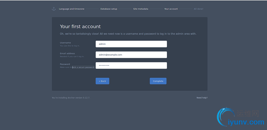

  Provide your admin username, password and email, then click on the Complete button. You should see the following page:
