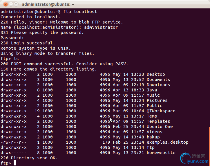

  5. restart vsftpd,and connect with root account (reminder: you can enable root account simply change root account and login in with root ,have a try)
  by default, the ftp root directory is the user's home directory !
  login with another account
