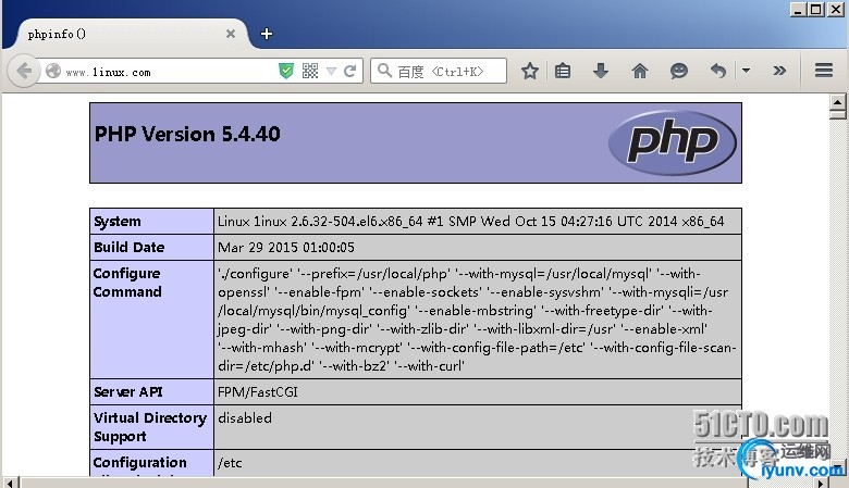

[iyunv@1inux php-5.4.40]# service php-fpm start
8、验证是否启动成功 (如果此命令输出有中几个php-fpm进程就说明启动成功了):
[iyunv@1inux php-5.4.40]# ps aux | grep php-fpm
root     121717  0.0  0.4 253684  4308 ?        Ss   03:19   0:00 php-fpm: master process (/usr/local/php/etc/php-fpm.conf)
nobody   121800  0.7  2.2 259076 20700 ?        S    03:24   0:17 php-fpm: pool www
nobody   121816  0.4  2.5 261892 23372 ?        S    03:28   0:08 php-fpm: pool www
nobody   121817  0.3  2.2 259076 20700 ?        S    03:28   0:07 php-fpm: pool www

4、接下来创建index.php页面,测试php是否能正常工作
[iyunv@1inux nginx]# vim  /usr/local/nginx/html/index.php
<?php
phpinfo();
5、访问主页
能够正常访问,说明 nginx+ php  已经配置完成

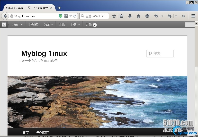

6、在nginx中添加虚拟主机配置WordPress blog
编辑配置文件/etc/nginx/nginx.conf,添加如下内容:server {
10
11
12
13
14
15
16
17
        listen 80;
        server_name blog.1inux.com;
        access_log logs/blog.access;  //其日志目录为: /usr/local/nginx/logs/blog.access
        error_log logs/blog.error;
        location / {
                root /vhost/blog;
                index index.php index.html index.htm;
        location ~ \.php$ {
            root           /vhost/blog;
            fastcgi_pass   127.0.0.1:9000;
            fastcgi_index  index.php;
            #fastcgi_param  SCRIPT_FILENAME  /scripts$fastcgi_script_name;
            fastcgi_param  SCRIPT_FILENAME  $document_root$fastcgi_script_name;
            include        fastcgi_params;
创建目录
# mkdir -pv /vhost/blog/
# unzip wordpress-3.2.1-zh_CN.zip
# mv wordpress/* /vhost/blog/
# chown -R nginx:nginx /vhost/blog
创建数据库及数据库用户密码
[iyunv@1inux ~]# mysql
MariaDB [(none)]> create database wpdb;
MariaDB [(none)]> GRANT ALL ON wpdb.* TO wpuser@'localhost' IDENTIFIED BY 'wppass';
MariaDB [wpdb]> GRANT ALL ON wp.* TO wpuser@'172.16.66.%' IDENTIFIED BY 'wppass';
然后安装.......访问
