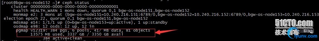

[iyunv@bgw-os-node152 ~]# ceph status
   cluster 00000000-0000-0000-0000-000000000001
    health HEALTH_WARN 1 mons down, quorum 0,1 bgw-os-node151,bgw-os-node152
    monmap e2: 3 mons at{bgw-os-node151=10.240.216.151:6789/0,bgw-os-node152=10.240.216.152:6789/0,bgw-os-node153=10.240.216.153:6789/0},election epoch 22, quorum 0,1 bgw-os-node151,bgw-os-node152
    mdsmap e14: 1/1/1 up {0=bgw-os-node153=up:active}, 1 up:standby
    osdmap e98: 12 osds: 12 up, 12 in
     pgmap v12319: 384 pgs, 6 pools, 417 MB data, 81 objects
           13575 MB used, 3337 GB / 3350 GB avail
                384 active+clean
数据正常:)

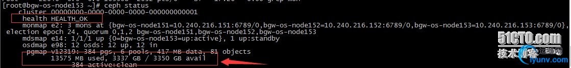

[iyunv@bgw-os-node153 ~]# ceph status
    health HEALTH_OK
    monmap e2: 3 mons at{bgw-os-node151=10.240.216.151:6789/0,bgw-os-node152=10.240.216.152:6789/0,bgw-os-node153=10.240.216.153:6789/0},election epoch 24, quorum 0,1,2 bgw-os-node151,bgw-os-node152,bgw-os-node153
                 384 active+clean
到此添加mon节点就完成啦!
