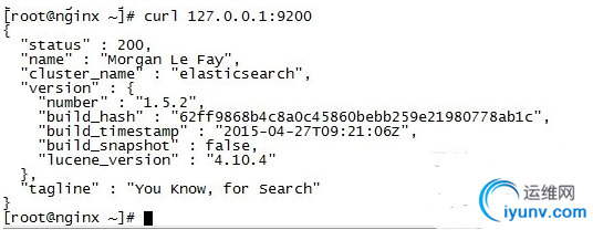

[iyunv@nginx ~]# curl 127.0.0.1:9200
说明启动成功
