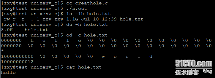

二、利用lseek()产生空洞文件(hole)
说明:
The lseek() function allows the file offset to be set beyond the end of the file (but this does not change the size of the file).  If  data  is later written at this point, subsequent  reads of the data in the gap (a "hole") return null bytes ('\0') until data is  actually  written  into the gap.
程序代码:
#include <stdio.h>#include <unistd.h>#include <fcntl.h>#include <stdlib.h>#define ERR_EXIT(m) \    do \    { \        perror(m); \        exit(EXIT_FAILURE); \    } while(0)int main(void){    int fd;    int ret;    fd = open("hole.txt",O_WRONLY|O_CREAT|O_TRUNC,0644);    if(fd == -1)        ERR_EXIT("open error");    write(fd,"hello",5);    ret = lseek(fd,1024*1024*1024,SEEK_CUR);    if(ret == -1)        ERR_EXIT("lseek error");    write(fd,"world",5);    close(fd);    return 0;}
测试结果:
程序创建一个hole文件,然后写入”hello”字符,在利用lseek系统调用从当前位置偏移到1024*1024*1024之后再写入”world”字符,ls显示文件大小为1.1G,实际上它并没有占用这么多的磁盘空间,du表明hole文件只有8k,系统只是存储一些信息,用它来表示有多少个\0,当我们用cat查看文件内容时只看到hello,由于文件太大最后的world太后以致看不到,但当我们用od命令查看时,可以发现有好多个\0。
