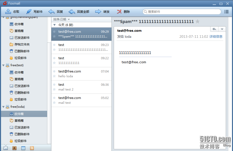

(3).垃圾邮件的测试
[iyunv@mail ~]#  cd /usr/share/doc/spamassassin-3.3.1/
[iyunv@mail spamassassin-3.3.1]# sendmail [email]test@free.com[/email] < sample-spam.txt
[iyunv@mail spamassassin-3.3.1]# tail -f /var/log/maillog
Jul 11 09:15:46 mail postfix/cleanup[17529]: 6AB1E23776: message-id=<[email]GTUBE1.1010101@example.net[/email]>
Jul 11 09:15:46 mail postfix/qmgr[17492]: 6AB1E23776: from=<[email]root@free.com[/email]>, size=1657, nrcpt=1 (queue active)
Jul 11 09:15:46 mail amavis[17520]: (17520-01) Passed SPAM {RelayedTaggedInbound,Quarantined}, <[email]root@free.com[/email]> -> <[email]test@free.com[/email]>, quarantine: spam-rnWvh9AXIRB2.gz, Message-ID: <[email]GTUBE1.1010101@example.net[/email]>, mail_id: rnWvh9AXIRB2, Hits: 1005.069, size: 933, queued_as: 6AB1E23776, 2403 ms
Jul 11 09:15:46 mail postfix/smtp[17533]: D927923774: to=<[email]test@free.com[/email]>, relay=127.0.0.1[127.0.0.1]:10024, delay=2.7, delays=0.21/0.07/0.02/2.4, dsn=2.0.0, status=sent (250 2.0.0 from MTA(smtp:[127.0.0.1]:10025): 250 2.0.0 Ok: queued as 6AB1E23776)\
从日志中我们可以看出进行了垃圾邮件过滤,嘿嘿,但效果不明显我们用Webmail测试一下,效果如下,
这就是我们刚才测试的垃圾邮件,嘿嘿!下面我们再发一封测试一下,
这是我们用test@free.com发给loda@free.com的邮件,我们用loda@free.com接收一下看看效果,
可以看到,当loda接收到这封邮件时,被标记为垃圾邮件!至此所有演示全部完成,嘿嘿,下面我们查看一下所启动的所有服务!
