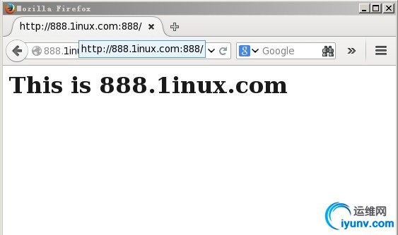

编辑配置文件  在http {} 中添加如下:
        server {
                listen 888;
                server_name 888.1inux.com;
                root "/vhost/888/html/";
重新加载
[iyunv@1inux nginx]# /usr/local/nginx/sbin/nginx -s reload
[iyunv@1inux nginx]# ss -tnlp | grep nginx
LISTEN     0      128                       *:888                      *:*      users:(("nginx",6568,11),("nginx",7659,11))
LISTEN     0      128                       *:80                       *:*      users:(("nginx",6568,6),("nginx",7659,6))
添加主页面
# echo "<h1> This is 888.1inux.com </h1>" > /vhost/888/html/index.html
然后访问如图
