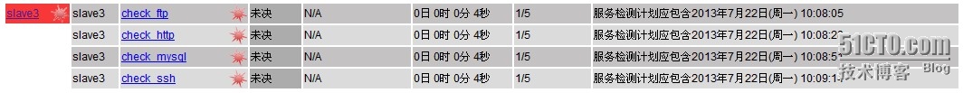

} 100332748.jpg 添加服务:[iyunv@localhost nagios]# ./autocservice.sh
Please input your hostname :slave3
please input the number of the services you want to set :4
Please input the services' name :
http ssh mysql ftp [iyunv@localhost nagios]# cat etc/services/slave3.cfg
define service{
use     generic-service,services-pnp
        host_name       slave3
        service_description     check_http
        check_command           check_nrpe!check_http
        max_check_attempts 5
        normal_check_interval 1
define service{
        host_name       slave3
        service_description     check_ssh
        check_command           check_nrpe!check_ssh
define service{
        host_name       slave3
        service_description     check_mysql
        check_command           check_nrpe!check_mysql
define service{
        host_name       slave3
        service_description     check_ftp
        check_command           check_nrpe!check_ftp
