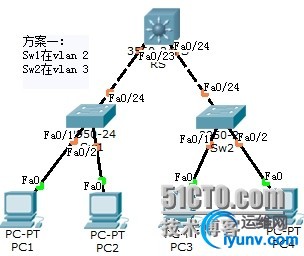

网络拓扑结构设计(粘贴PT的拓扑图)
方案一:SW1连接A部门的计算机,SW2连接B部门计算机,两台二层交换机不做任何配置,仅用于网络接入,而这两台二层交换机上行线路分别连接到RS交换机的一个VLAN,为RS的两个VLAN配置IP地址即可实现VLAN间路由功能。这种网络的规划和配置适合于A、B两部门的计算机相对独立的连接在各自的交换机上,仅需要解决的是两个部门之间的路由问题。
        方案一配置:
Rs
RS#show run
Building configuration...
Current configuration : 1307 bytes
version 12.2
no service timestamps log datetime msec
no service timestamps debug datetime msec
no service password-encryption
hostname RS
ip routing
spanning-tree mode pvst
interface FastEthernet0/1
(省略……)
interface FastEthernet0/23
switchport access vlan 2
switchport mode access
interface FastEthernet0/24
switchport access vlan 3
interface GigabitEthernet0/1
interface GigabitEthernet0/2
interface Vlan1
no ip address
shutdown
interface Vlan2
ip address 192.168.1.254 255.255.255.0
interface Vlan3
ip address 192.168.2.254 255.255.255.0
ip classless
line con 0
line aux 0
line vty 0 4
login
end
试以及查看RS的路由
RS# show ip route
Codes: C - connected, S - static, I - IGRP, R - RIP, M - mobile, B - BGP
       D - EIGRP, EX - EIGRP external, O - OSPF, IA - OSPF inter area
       N1 - OSPF NSSA external type 1, N2 - OSPF NSSA external type 2
       E1 - OSPF external type 1, E2 - OSPF external type 2, E - EGP
       i - IS-IS, L1 - IS-IS level-1, L2 - IS-IS level-2, ia - IS-IS inter area
       * - candidate default, U - per-user static route, o - ODR
       P - periodic downloaded static route
Gateway of last resort is not set
C    192.168.1.0/24 is directly connected, Vlan2
C    192.168.2.0/24 is directly connected, Vlan3
