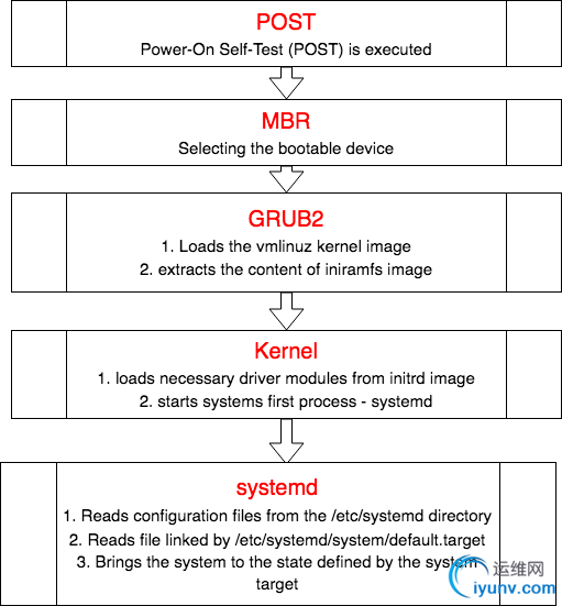

The following steps summarize how the boot procedure happens in RHEL/CentOS 7.
  •   The computer’s BIOS performs POST.
  •   BIOS reads the MBR for the bootloader.
  •   GRUB 2 bootloader loads the vmlinuz kernel image.
  •   GRUB 2 extracts the contents of the initramfs image.
  •   The kernel loads driver modules from initramfs.
  •   Kernel starts the system’s first process, systemd.
  •   The systemd process takes over. It:
  •   Reads configuration files from the /etc/systemd directory
  •   Reads file linked by /etc/systemd/system/default.target
  •   Brings the system to the state defined by the system target
  •   Executes /etc/rc.local

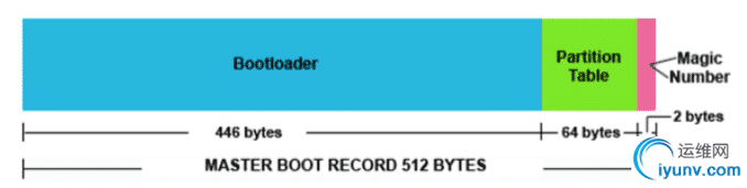

2. Selecting the bootable device (With MBR)
– Master Boot Record (MBR) is the first 512 bytes of the boot drive that is read into memory by the BIOS.
– The next 64 bytes contain the partition table for the disk. The last two bytes are the “Magic Number” which is used for error detection.
– MBR discovers the bootable device and loads the GRUB2 boot loader into memory and transfers control over to it.

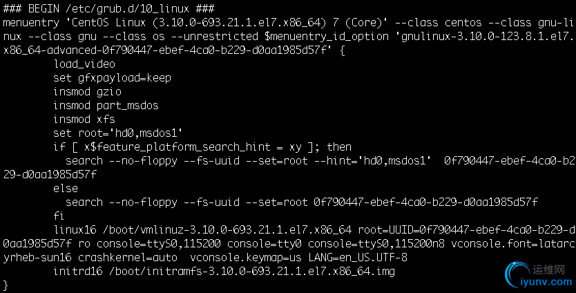

3. Loading the boot loader (GRUB2)
– The default bootloader program used on RHEL 7 is GRUB 2. GRUB stands for GRand Unified Bootloader. GRUB 2 replaces the older GRUB bootloader also called as legacy GRUB.
– The GRUB 2 configuration file is located at /boot/grub2/grub.cfg (Do not edit this file directly).
– GRUB 2 menu-configuration settings are taken from /etc/default/grub when generating grub.cfg.
– Sample /etc/default/grub file :
# cat /etc/default/grub
GRUB_TIMEOUT=5
GRUB_DEFAULT=saved
GRUB_DISABLE_SUBMENU=true
GRUB_TERMINAL_OUTPUT="console"
GRUB_CMDLINE_LINUX="rd.lvm.lv=rhel/swap crashkernel=auto rd.lvm.lv=rhel/root rhgb quiet net.ifnames=0"
GRUB_DISABLE_RECOVERY="true"– If changes are made to any of these parameters, you need to run grub2-mkconfig to re-generate the /boot/grub2/grub.cfg file.
# grub2-mkconfig –o /boot/grub2/grub.cfg– GRUB2 searches the compressed kernel image file also called as vmlinuz in the /boot directory.
