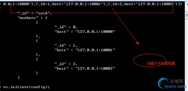

>config = {_id: 'sky', members: [
{_id: 0, host: '192.168.10.107:9998'},
{_id: 1, host: '192.168.10.106:9998'},
{_id: 2, host: '192.168.10.103:9998'}]
配置文件的语法是:

>rs.initiate(config) 出现以下提示为配置成功
"info" : "Config now saved locally. Should come online in about a minute.",
"ok" : 1
