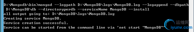

  3.D:\Mongodb\bin>mongod --logpath D:\MongoDB\logs\MongoDB.log --logappend --dbpath D:\MongoDB\db --directoryperdb --serviceName MongoDB --install
  如果安装成功,显示下面文字
  all output going to: D:\MongoDB\logs\MongoDB.log
Creating service MongoDB.
Service creation successful.
Service can be started from the command line via 'net start "MongoDB"'.
