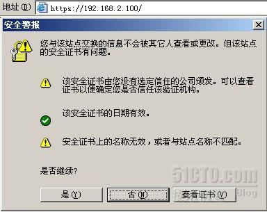

五:客户端访问站点

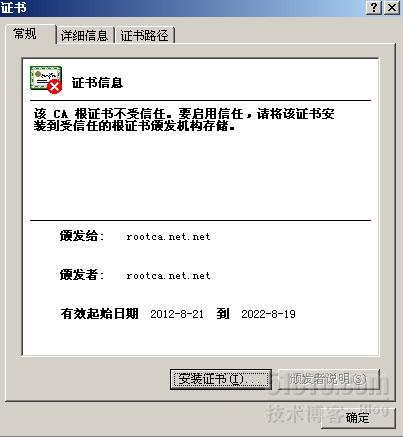

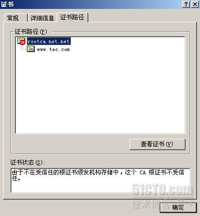

6.打开证书链,并在客户端安装根证书
vim /etc/httpd/conf.d/ssl.conf
128 SSLCertificateChainFile /etc/pki/CA/cacert.pem

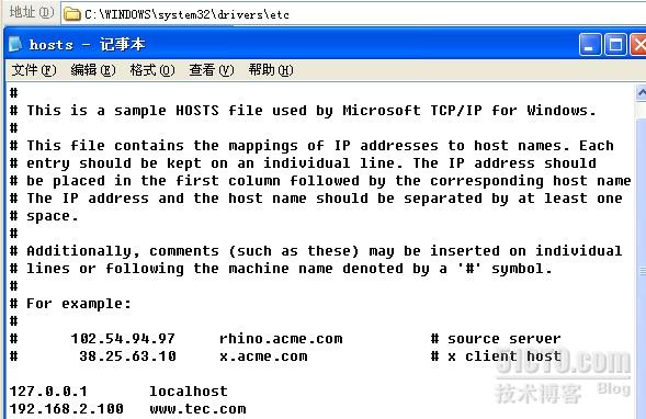

7.客户端编辑host文件,并访问

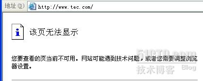

8.关闭http访问
vim /etc/httpd/conf/httpd.conf
#Listen 80      //关闭80端口
[iyunv@localhost ~]# service httpd restart
