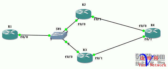

HSRP+SLA实验
当跟踪的对象失效后,默认5秒重发一次,尝试3次,3次都失败,开始切换。
R2配置:
track 10 ip sla 10 reachability
ip sla 10
tcp-connect 4.4.4.4 23 source-ip 123.1.1.2
ip sla schedule 10 life forever start-time now
interface FastEthernet0/0
ip address 123.1.1.2 255.255.255.0
duplex auto
speed auto
standby 1 ip 123.1.1.254
standby 1 priority 150
standby 1 preempt
standby 1 track 10 decrement 50
R3配置:
track 20 ip sla 20 reachability
ip sla 20
tcp-connect 4.4.4.4 23 source-ip 123.1.1.3
ip sla schedule 20 life forever start-time now
ip address 123.1.1.3 255.255.255.0
duplex auto
speed auto
standby 1 priority 110
standby 1 preempt
standby 1 track 20 decrement 80
R4配置:
ip sla responder
VRRP
