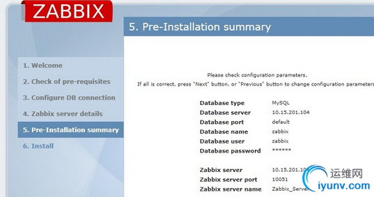

Hostname=10.15.201.104     #最好使用agent节点的IP
cp misc/init.d/fedora/core/zabbix_* /etc/init.d/
chmod +x /etc/init.d/zabbix_*
chkconfig --add zabbix_agentd
chkconfig --add zabbix_server
vim /etc/init.d/zabbix_server
BASEDIR=/usr/local/zabbix
vim /etc/init.d/zabbix_agentd
cd /opt/zabbix-2.4.3
cp -a  frontends/php/*   /usr/local/nginx/html/zabbix/
需要修改php.ini 并重启php-fpm
# vim /etc/php.ini
post_max_size = 16M
max_execution_time = 300
max_input_time = 300
date.timezone = Asia/Shanghai
always_populate_raw_post_data = 1
cd /opt/php-5.6.5/ext/gettext
/usr/local/php/bin/phpize
./configure --with-php-config=/usr/local/php/bin/php-config
mkae && make install
vim /etc/php.ini
extension = /usr/local/php/lib/php/extensions/no-debug-non-zts-20131226/gettext.so
