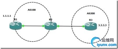

R1#sh run | se bgp
router bgp 100
no synchronization
bgp log-neighbor-changes
neighbor 12.1.1.2 remote-as 100
no auto-summary
R2#sh run | se bgp
router bgp 100
no synchronization
neighbor 12.1.1.1 remote-as 100
neighbor 23.1.1.3 remote-as 200
no auto-summary
R3#sh run | se bgp
router bgp 200
no synchronization
network 3.3.3.0 mask 255.255.255.0
neighbor 23.1.1.2 remote-as 100
no auto-summary

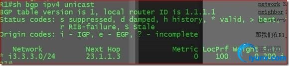

那我们在R1上看到3.3.3.0网段
发现3.3.3.0并不时最优
我们在R2 上作个next-hop-self
R2(config-router)#nei 12.1.1.1 next-hop-self \\参数是为了解决下一跳可达的问
R1#sh bgp ipv4 unicast
BGP table version is 2, local router ID is 1.1.1.1
Status codes: s suppressed, d damped, h history, * valid, > best, i - internal,
r RIB-failure, S Stale
Origin codes: i - IGP, e - EGP, ? - incomplete
Network Next Hop Metric LocPrf Weight Path
*>i3.3.3.0/24 12.1.1.2 0 100 0 200 i
等再次查看3.3.3.0已是最优路由

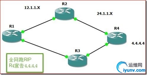

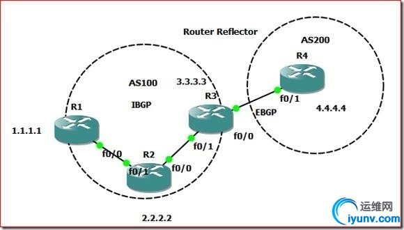

R1#sh run | se bgp
router bgp 100
no synchronization
neighbor 3.3.3.3 remote-as 100
neighbor 3.3.3.3 update-source Loopback0
neighbor 3.3.3.3 next-hop-self
no auto-summary
R3#sh run | se bgp
router bgp 100
no synchronization
neighbor 1.1.1.1 remote-as 100
neighbor 1.1.1.1 update-source Loopback0
neighbor 1.1.1.1 next-hop-self
neighbor 34.1.1.4 remote-as 200
no auto-summary
R4#sh run | se bgp
router bgp 200
no synchronization
network 4.4.4.0 mask 255.255.255.0
neighbor 34.1.1.3 remote-as 100
no auto-summary

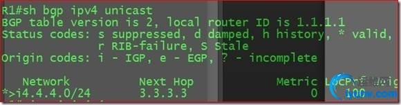

在R1上我们可以看到4.4.4.0的路由,且是最优的,下一跳为3.3.3.3
但实际上R1是ping不通4.4.4.4的
因为包的传递还是hop by hop,在R2 上没有去4.4.4.4的路由
所以不开启同步很有可能会有路由黑洞
我们在R1 R3开启同步
R3(config-router)#synchronization
BGP table version is 1, local router ID is 1.1.1.1
* i4.4.4.0/24 3.3.3.3 0 100 0 200 i
然后打开同步解决了黑洞问题,但实际上R1还是通不了4.4.4.4,所以同步默认是关闭的
Final solution:是as100所有路由器都跑bgp
Better solution:联邦和发射器
Best solution:MPLS

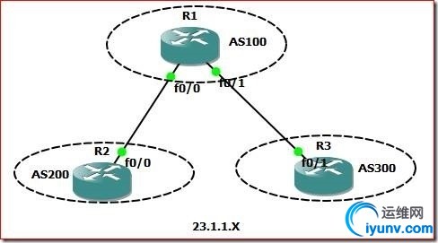

3-Peer Group我们用peer group来做上面的试验 让 R1/2/3相互指邻居
router bgp 100
no synchronization
neighbor fuyi peer-group
neighbor fuyi remote-as 100
neighbor fuyi update-source Loopback0
neighbor fuyi next-hop-self
neighbor 2.2.2.2 peer-group fuyi
neighbor 3.3.3.3 peer-group fuyi
no auto-summary

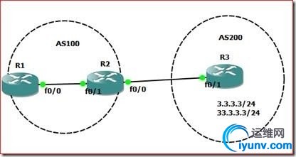

下面我们来证明这两点:
R1#sh run | se bgp
router bgp 100
no synchronization
bgp router-id 1.1.1.1
neighbor 12.1.1.2 next-hop-self
no auto-summary
R2#sh run | se bgp
router bgp 100
no synchronization
bgp router-id 2.2.2.2
neighbor 12.1.1.1 next-hop-self
no auto-summary
R3#sh run | se bgp
router bgp 200
no synchronization
bgp router-id 3.3.3.3
network 33.3.3.0 mask 255.255.255.0
no auto-summary

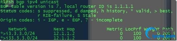

我们在R1上看BGP的拓扑表如下:
BGP table version is 3, local router ID is 1.1.1.1
*>i33.3.3.0/24 12.1.1.2 0 100 0 200 i
如果我们在R3 敲入自动汇总
R3(config-router)#auto-summary
其实在R1上看BGP拓扑表的结果和上面一样
说明自动汇总并没有对明细路由汇总并没有汇总!!!!!
打开自动汇总的影响是: 此时可以去宣告一个主类网络
R3(config-router)#net 3.0.0.0
R3(config-router)#net 33.0.0.0
在R1可以看到BGP拓扑表
我们在R2 上起环回接口2.2.2.2 重分布进BGP
R2(config)#router bgp 100
R2(config-router)#auto-summary
R2(config-router)#redistribute connected
R2#sh bgp ipv4 unicast
BGP table version is 26, local router ID is 2.2.2.2
*> 2.0.0.0 0.0.0.0 0 32768 ?
*> 3.0.0.0 23.1.1.3 0 0 200 i
*> 3.3.3.0/24 23.1.1.3 0 0 200 i
*> 12.0.0.0 0.0.0.0 0 32768 ?
*> 23.0.0.0 0.0.0.0 0 32768 ?
*> 33.0.0.0 23.1.1.3 0 0 200 i
*> 33.3.3.0/24 23.1.1.3 0 0 200 i
可见:如果开起自动汇总,重分布进BGP的路由是会自动汇总!!

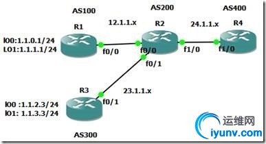

本实验实现在路由器R2 上将路由器R1 和路由器R3 通告的环回接口的路由进行地址聚
合,并通告给路由器R4。在路由器R1、R3、R4 配置静态路由实现网络互通。
<基本配置如下:>

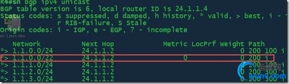

如果我们在R2上作BGP手工汇总
R2(config-router)#aggregate-address 1.1.0.0 255.255.252.0
R4 上看BGP拓扑表:
实际上手工汇总并没有抑制明晰路由,源AS path属性丢失(原来是100 300)
6-1 AS-SETR2(config-router)#aggregate-address 1.1.0.0 255.255.252.0 as-set
PS: BGP 路由器下一跳为“0.0.0.0”,表示该BGP 路由起源本地,Weight 值为“32768”
R4#sh bgp ipv4 unicast
BGP table version is 11, local router ID is 24.1.1.4
*> 1.1.0.0/22 24.1.1.2 0 0 200 {100,300} i
应该看到了变化吧?没有明细路由了,且保留ASPATH属性
携带ASPATH的目的就是为了防环 (不带参数AS-SET之前,R2会把路由发回给R1和R3,但现在R1/R3不接受 R2回传的路由了)

6-4 Advertise-Map条件通告,指的是当route-map里匹配的路由(此路由必须是被包含在汇总路由里的明细路由)在BGP表存在时,汇总路由才能生成。
如果使用了as-set参数,汇总路由只继承了route-map里匹配的路由属性
我们用advertise-map去匹配1.1.0.0/24这条路由,当这条路由存在时,R2就会产生汇总,传递给R4.
R2(config)#ip prefix-list ADV permit 1.1.0.0/24
R2(config)#route-map adv permit 10
R2(config-route-map)#match ip address prefix-list ADV
R2(config-router)#aggregate-address 1.1.0.0 255.255.252.0 as-set advertise-map adv

如果我们在R1上
R1(config-router)#no network 1.1.0.0 mask 255.255.255.0
那么我们在R4上还能看到汇总路由吗? (答案是看不到的)
*> 1.1.1.0/24 12.1.1.1 0 0 100 i
*> 1.1.2.0/24 23.1.1.3 0 0 300 i
*> 1.1.3.0/24 23.1.1.3 0 0 300 i
R4#sh ip bgp
BGP table version is 18, local router ID is 24.1.1.4
*> 1.1.1.0/24 24.1.1.2 0 200 100 i
*> 1.1.2.0/24 24.1.1.2 0 200 300 i
*> 1.1.3.0/24 24.1.1.2 0 200 300 i
\\R4 没有看到没有汇总路由,说明汇总命令在R2上失效了

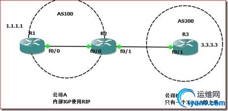

7-BGP的默认路由拓扑图如下
下放默认路由使R1的loopback口1.1.1.1能与R3的loopback口3.3.3.3 相PING通
基本配置就是R2能与R3相互起邻居
R2#sh ip bgp summary
BGP router identifier 22.2.2.2, local AS number 100
BGP table version is 1, main routing table version 1
Neighbor V AS MsgRcvd MsgSent TblVer InQ OutQ Up/Down State/PfxRcd
12.1.1.1 4 100 4 4 0 0 0 00:00:30 0
23.1.1.3 4 200 4 4 0 0 0 00:00:30 0
7-1静态路由+宣告产生默认路由R3(config)#ip route 0.0.0.0 0.0.0.0 f0/1 23.1.1.2
R3(config)#router bgp 200
R3(config-router)#net 0.0.0.0 mask 0.0.0.0
R2#sh ip route
Gateway of last resort is 23.1.1.3 to network 0.0.0.0
1.0.0.0/24 is subnetted, 1 subnets
R 1.1.1.0 [120/1] via 12.1.1.1, 00:00:24, FastEthernet0/0
23.0.0.0/24 is subnetted, 1 subnets
C 23.1.1.0 is directly connected, FastEthernet0/1
12.0.0.0/24 is subnetted, 1 subnets
C 12.1.1.0 is directly connected, FastEthernet0/0
B* 0.0.0.0/0 [20/0] via 23.1.1.3, 00:04:19
R1#sh ip route
Gateway of last resort is 12.1.1.2 to network 0.0.0.0
C 1.1.1.0 is directly connected, Loopback0
B* 0.0.0.0/0 [200/0] via 12.1.1.2, 00:05:05
R3#ping 1.1.1.1
Type escape sequence to abort.
Sending 5, 100-byte ICMP Echos to 1.1.1.1, timeout is 2 seconds:
Success rate is 100 percent (5/5), round-trip min/avg/max = 28/56/124 m
7-2 重分布+ Default Information Originate产生默认路由R3(config-router)#router bgp 200
R3(config-router)#no net 0.0.0.0 mask 0.0.0.0 \\删除之前的配置
R3(config-router)#redistribute static
R3(config-router)#default-information originate
R3依旧是能ping通R1的

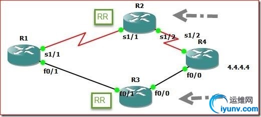

8-BGP路由反射器当一个AS 包含多个IBGP 对等体时,路由反射器非常有用。因为IBGP 客户只需要和路
由反射器建立邻居关系,从而降低了IBGP 的连接数量。路由反射器和它的客户合称为一个
(Cluster)。路由反射器是克服IBGP 水平分割的重要手段。
8-1反射规则RR 的反射规则如下:
(1)如果路由是从非客户的IBGP邻居学来的,则RR只将它反射给客户;(不会反射到非客户)
(2)如果路由是从客户学来的,RR会将它反射给所有的非客户和客户(除了发起该路
由的客户);
(3)如果路由是从EBGP邻居学来的,RR会将它反射给所有的非客户和客户。
R2# neighbor 3.3.3.3 route-reflector-client\\代表R2 是R3的RR(R2指R3为客户), R2作反射动作
8-2反射防环RR打破了BGP的水平分割,所以可能导致环路,为了防环,用了下面的技术来防环:

R2#sh bgp ipv4 unicast neighbors 1.1.1.1
BGP neighbor is 1.1.1.1, remote AS 100, internal link
BGP version 4, remote router ID 1.1.1.1
BGP state = Established, up for 00:27:16
Last read 00:00:15, last write 00:00:14, hold time is 180, keepalive interval is 60 seconds
Neighbor capabilities:
Route refresh: advertised and received(new)
New ASN Capability: advertised and received
Address family IPv4 Unicast: advertised and received
For address family: IPv4 Unicast
BGP table version 10, neighbor version 10/0
Output queue size : 0
Index 2, Offset 0, Mask 0x4
Route-Reflector Client\\R1是R2 (RR)的客户端
R2#sh ip bgp 4.4.4.0
BGP routing table entry for 4.4.4.0/24, version 10
Paths: (1 available, best #1, table Default-IP-Routing-Table)
Flag: 0x820
Advertised to update-groups:
200, (Received from a RR-client)
3.3.3.3 (metric 156160) from 3.3.3.3 (3.3.3.3) \\从R3学习到,发射给R1
Origin IGP, metric 0, localpref 100, valid, internal, best
R1#sh ip bgp 4.4.4.0
Not advertised to any peer
200
3.3.3.3 (metric 158720) from 2.2.2.2 (2.2.2.2)
Originator: 3.3.3.3, Cluster list: 2.2.2.2 \\起源ID为R3的RouterID,cluster list ID 为R2 的router ID
8-3反射术语① ORIGINATOR_ID:由路由反射器生成,默认是本AS内路由创造者的路由器ID;
② CLUSTER_ID(簇ID): 一个AS 内的每个簇必须用一个唯一的4 个字节的簇ID 来标
识,如果簇内只有一个RR,那么簇ID 就是RR 的路由器ID。当RR 收到一个更新消息的时候,
它检查CLUSTER_LIST,如果发现在列表中有自己的簇ID,就知道出现了路由环路。当然我们可以手工配置cluster id
命令:bgp cluster-ID X.X.X.X

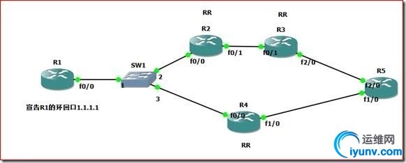

8-4 RR Cluster再来看个实验深入了解路由反射器
R1#sh run | se bgp
router bgp 100
no synchronization
network 1.1.1.0 mask 255.255.255.0
neighbor 12.1.1.2 remote-as 200
no auto-summary
R2#sh run | se bgp
router bgp 200
no synchronization
neighbor 12.1.1.1 default-originate \\使R5能ping通1.1.1.1
neighbor 23.1.1.3 next-hop-self
neighbor 24.1.1.4 remote-as 200
neighbor 24.1.1.4 next-hop-self
no auto-summary
R3#sh run | se bgp
router bgp 200
no synchronization
neighbor 23.1.1.2 remote-as 200
neighbor 23.1.1.2 route-reflector-client
neighbor 23.1.1.2 next-hop-self
neighbor 34.1.1.4 next-hop-self
neighbor 35.1.1.5 remote-as 200
neighbor 35.1.1.5 next-hop-self
no auto-summary
R4#sh run | se bgp
router bgp 200
no synchronization
neighbor 24.1.1.2 remote-as 200
neighbor 24.1.1.2 route-reflector-client
neighbor 24.1.1.2 next-hop-self
neighbor 34.1.1.3 remote-as 200
neighbor 34.1.1.3 next-hop-self
neighbor 45.1.1.5 remote-as 200
neighbor 45.1.1.5 next-hop-self
no auto-summary
R5#sh run | se bgp
router bgp 200
no synchronization
neighbor 35.1.1.3 remote-as 200
neighbor 35.1.1.3 next-hop-self
neighbor 45.1.1.4 remote-as 200
neighbor 45.1.1.4 next-hop-self
no auto-summary
看R1怎么防环
R2#sh ip bgp 1.1.1.0
BGP routing table entry for 1.1.1.0/24, version 2
100
12.1.1.1 from 12.1.1.1 (1.1.1.1)
Origin IGP, metric 0, localpref 100, valid, external, best
\\因为起源ID(Originator: 24.1.1.2) 相同所以R2不会接受自己发出去的路由
看R5学习到的1.1.1.0路由 说明R3/4反射了1.1.1.0给R5
R5#sh ip bgp 1.1.1.0
BGP routing table entry for 1.1.1.0/24, version 3
Paths: (2 available, best #2, table Default-IP-Routing-Table)
100
24.1.1.2 (metric 1) from 45.1.1.4 (45.1.1.4)
Originator: 24.1.1.2, Cluster list: 45.1.1.4 \\来自R4
100
23.1.1.2 (metric 1) from 35.1.1.3 (35.1.1.3)
Originator: 24.1.1.2, Cluster list: 35.1.1.3 \\来自R3
R3#sh ip bgp 1.1.1.0 (R4同理)
100
24.1.1.2 (metric 1) from 34.1.1.4 (45.1.1.4)
Originator: 24.1.1.2, Cluster list: 45.1.1.4 \\来自R4反射
100, (Received from a RR-client)
23.1.1.2 from 23.1.1.2 (24.1.1.2)
Origin IGP, metric 0, localpref 100, valid, internal, best \\来自EBGP
R3#sh ip bgp
BGP table version is 2, local router ID is 35.1.1.3
* i1.1.1.0/24 24.1.1.2 0 100 0 100 i
*>i 23.1.1.2 0 100 0 100 i
在R3/4同时做下面配置
R3/4(config-router)#bgp cluster-id 34.34.34.34 \\配置为RR Cluster
R3#sh ip bgp 1.1.1.1
\\R3拒绝让cluster ID 相同的路由加表, 如果发现在cluster列表中有自己的簇ID,就知道出现了路由环路

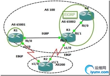

9-BGP联邦BGP 联邦用于将AS 分割成多个子AS,是控制大型IBGP 对等的另一条途径。而子AS被称
为成员自治系统。每个联邦都有被分配一个联邦ID,对联邦外部来讲,这个联邦ID是代表
整个联邦的AS 号码。外部看不到联邦内部结构,联邦看起来就是一个AS,成员自治系统信
息被隐藏起来。
联邦主要就2个命令
R1(config-router)#bgp confederation identifier 100 //配置联邦ID
R1(config-router)#bgp confederation peers 65002 //联邦EBGP 对等的成员
下面具体看下每个router的配置
R1#sh run | se bgp
router bgp 65001
no synchronization
neighbor 13.1.1.3 remote-as 65002

联邦总结:
1 BGP 联邦内所有成员的AS PATH信息对外都被隐藏
2 联邦内的AS-PATH 用“()”表示
在联邦范围内,将成员AS 加入到AS-PATH 中,并且用括号扩起来,但是并不将它们公
布到联邦的范围以外。AS-PATH 中联邦的AS 号用于避免出现路由环路。
10-BGP团体Community 默认是不会被传递的
在上面的实验中完成团体实验
通过让路由器R4 上的“4.4.4.0”携带不同的团体属性,来验证团体的各个属性的传递特征。
对团体的讨论,我们仅仅讨论熟知的属性“local-AS”、“no-export”和“no-advertise”
默认是’Internet’ (无限制)
10-1 Local AS在R4上配置:
R4(config)#ip prefix-list 1 permit 4.4.4.0/24
R4(config)#route-map LocalAS
R4(config-route-map)#match ip address prefix-list 1
R4(config-route-map)#set community local-AS
R4(config)#router bgp 65002
R4(config-router)#neighbor 3.3.3.3 send-community
R4(config-router)#neighbor 3.3.3.3 route-map LocalAS out
那么在R1/R2上BGP表中是看不到4.4.4.0路由的。
这表明携带团体“local-AS”属性的条目“4.4.4.0/24”只传递给路由器R3,因为路由器R3 和R4 都在AS 65002 内,并没有传递给路由器R2 和R1。由此可见“local-AS”团体属性只能在本AS 内(或联邦子AS内)传递。
10-2 no-exportR4(config)#route-map noexport
R4(config-route-map)#set community no-export
R4(config-router)#nei 3.3.3.3 route-map noexport out
R3(config-router)#nei 13.1.1.1 send-community
R1#sh ip bgp community no-export
BGP table version is 17, local router ID is 1.1.1.1
*> 4.4.4.0/24 13.1.1.3 0 100 0 (65002) i
携带团体“no-export”属性的条目“4.4.4.0/24”传递给路由器R3和R1,因为路由器R1、R3 和R4 都在联邦AS 100 内,并没有传递给路由器R2。
no-export团体属性能在联邦的大AS 内传递,如果没有联邦,只能在本AS内传递.

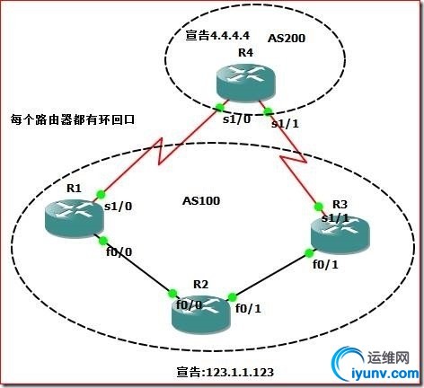

13-1 Weight该属性不传递,只在本机起作用
默认学习的路由weight value 为 0,但自身产生的路由weight值为32768
若作策略只能在in方向做
R1#sh run | se bgp
router bgp 100
no synchronization
bgp router-id 11.1.1.1
neighbor 2.2.2.2 remote-as 100
neighbor 2.2.2.2 update-source Loopback0
neighbor 2.2.2.2 next-hop-self
neighbor 14.1.1.4 remote-as 200
no auto-summary
R2#sh run | se bgp
router bgp 100
no synchronization
bgp router-id 22.1.1.1
network 123.1.1.0 mask 255.255.255.0
no auto-summary
R3#sh run | se bgp
router bgp 100
no synchronization
bgp router-id 33.1.1.1
no auto-summary
R4#sh run | se bgp
router bgp 200
no synchronization
bgp router-id 44.1.1.1
neighbor 14.1.1.1 remote-as 100
no auto-summary

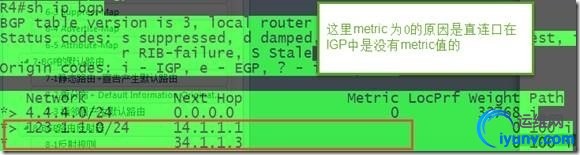

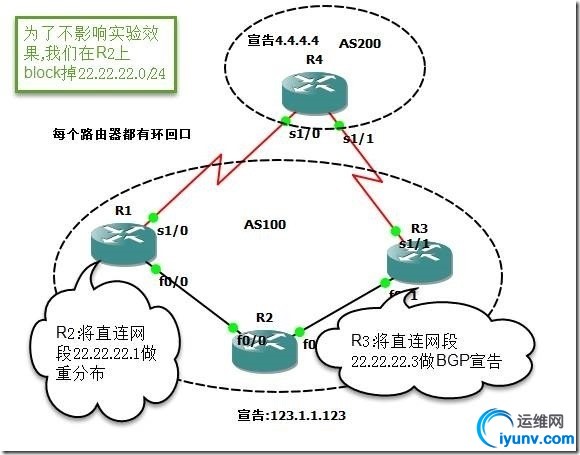

那么在R4上可以学习到123.1.1.X路由的两条路径
R4#sh ip bgp
BGP table version is 3, local router ID is 44.1.1.1
*> 4.4.4.0/24 0.0.0.0 0 32768 i
* 123.1.1.0/24 34.1.1.3 0 100 i
*> 14.1.1.1 0 100 i
GNS3 从R1先学习到EBGP路由,根据选路原则第10条,EBGP越老越优先的原则,默认是走14.1.1.1
要求改变选路,让其走34.1.1.3
R4(config-router)#neighbor 14.1.1.1 weight 300
R4(config-router)#nei 34.1.1.3 wei 500
或者
access-list 10 permit 123.1.1.0 0.0.0.255
neighbor 34.1.1.3 route-map wei2 in
route-map wei2 permit 10
match ip address 10
set weight 200
R4#sh ip bgp 123.1.1.0
BGP routing table entry for 123.1.1.0/24, version 15
Paths: (2 available, best #1, table Default-IP-Routing-Table)
Flag: 0x860
100
34.1.1.3 from 34.1.1.3 (33.1.1.1)
Origin IGP, localpref 100, weight 200, valid, external, best
100
14.1.1.1 from 14.1.1.1 (11.1.1.1)
Origin IGP, localpref 100, valid, external

13-5 Origin起源属性:I > E > ? (重分布等),可跨AS传递
R1#sh run | se bgp
redistribute connected route-map red \\red route-map抓直连路由22.22.22.X
route-map red permit 10
match ip address prefix-list 10
R2#sh run | se bgp
router bgp 100
neighbor 1.1.1.1 route-map Test in \\block 掉22.22.22.X
neighbor 3.3.3.3 route-map Test in
route-map Test deny 10
route-map Test permit 20
在R4上看BGP表:4#sh ip bgp 22.22.22.0
BGP routing table entry for 22.22.22.0/24, version 20
100
100
Origin incomplete, metric 0, localpref 100, valid, external
或者这个实验我们也可以这样做
R4(config)#ip prefix-list 10 permit 4.4.4.0/24

R1 学到两条关于“4.4.4.0/24”的路由,但是由于起源代码“i”优先于“e”,所以从路由器R3 学到的路由被优化,而从邻居路由器R4 学到的路由不能被优化(路由代码只为“*”,没有“>”),不能继续通告给路由器R2 和R3,所以路由器R2 和R3只有一条关于“4.4.4.0/24”的路由。
13-6 Med影响范围:两个直连AS间,优选小的值
BGP汇总默认med 为零
而宣告或者重分布则是默认把路由表中的metric值引入
默认情况下,只比较来自同一邻居AS的BGP路由的MED值,就是说如果同一个目的地的两条路有来自不同的AS,则不进行MED值得比较,MED只是在直接相连的AS之间影响业务量,而不会跨AS传递(MED信息只会传递给直连的AS邻居,在跨越了一个AS后,不携带这个属性),可以在IN/OUT方向调用
现在我们用Med属性来改变选路,让它优选34.1.1.3走向123.1.1.x
R1(config)#route-map med
R1(config-route-map)#match ip add prefix-list 10
R1(config-route-map)#set metric 5000
R1(config-router)#neighbor 14.1.1.4 route-map med out
R4#sh ip bgp
*> 123.1.1.0/24 34.1.1.3 0 100 i
* 14.1.1.1 5000 0 100 i
BGP routing table entry for 123.1.1.0/24, version 2
Flag: 0x820
100
Origin IGP, localpref 100, valid, external, best
100
Origin IGP, metric 5000, localpref 100, valid, external

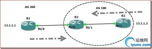

13-7 EBGP优先于IBGP第7条:如果有一条路由来自external/联邦/IBGP,则优选External,联盟,IBGP学来的路由
R1与R3分别宣告13.1.1.X ,看R2学那边?
记得R2做AS PATH ignore <IOS 不支持,所以这个实验没发做>
13-8 到达Next-Hop代价第8条:优选下一条度量值最低的路由, 优选low metric Next-Hop
全网跑OSPF
默认R1 IGP路由表
R1#sh ip route ospf
Codes: L - local, C - connected, S - static, R - RIP, M - mobile, B - BGP
D - EIGRP, EX - EIGRP external, O - OSPF, IA - OSPF inter area
N1 - OSPF NSSA external type 1, N2 - OSPF NSSA external type 2
E1 - OSPF external type 1, E2 - OSPF external type 2
i - IS-IS, su - IS-IS summary, L1 - IS-IS level-1, L2 - IS-IS level-2
ia - IS-IS inter area, * - candidate default, U - per-user static route
o - ODR, P - periodic downloaded static route, H - NHRP, l - LISP
+ - replicated route, % - next hop override
Gateway of last resort is not set
24.0.0.0/24 is subnetted, 1 subnets
O 24.1.1.0 [110/66] via 13.1.1.3, 00:00:05, FastEthernet0/1
34.0.0.0/24 is subnetted, 1 subnets
O 34.1.1.0 [110/2] via 13.1.1.3, 00:00:05, FastEthernet0/1
那么我们在R4上宣告4.4.4.4,看R1的BGP表
R1#sh ip bgp
BGP table version is 6, local router ID is 13.1.1.1
r RIB-failure, S Stale, m multipath, b backup-path, f RT-Filter,
x best-external, a additional-path, c RIB-compressed,
RPKI validation codes: V valid, I invalid, N Not found
*>i 4.4.4.0/24 34.1.1.4 <OSPF 中 Metric小> 0 100 0 i
* i 24.1.1.4 <OSPF 中 Metric大> 0 100 0 i
更大改去往 34.1.1.4路径的metric值
R1(config)#int f0/1
R1(config-if)#ip ospf cost 6000
R1#sh ip route ospf
O 24.1.1.0 [110/128] via 12.1.1.2, 00:00:04, Serial1/1
O 34.1.1.0 [110/129] via 12.1.1.2, 00:00:04, Serial1/1
R1#sh ip bgp
* i 4.4.4.0/24 34.1.1.4 0 100 0 i
*>i 24.1.1.4 0 100 0 I \\优先选metric小的next-hop
如果在路由器上配置了maximum—paths N,而且从同一个对等体自治域/子自治域接收到多条外部/外部联盟的路径,则最多可以将N条最近接收到的路径加入到IP路由选择表中
R1:
router bgp 100
neighbor 13.1.1.3 remote-as 100
maximum-paths ibgp 2
R1#sh ip bgp
BGP table version is 2, local router ID is 13.1.1.1
*mi 4.4.4.0/24 34.1.1.4 0 100 0 i
*>i 24.1.1.4 0 100 0 i

13-10 EBGP越老越优先如果是external的路由,优选最老的路由(最先被学习到的路由).
R2/R3都宣告23.1.1.X
R1#sh ip bgp 23.1.1.0
BGP routing table entry for 23.1.1.0/24, version 2
Paths: (2 available, best #2, table default)
Refresh Epoch 1
300
13.1.1.3 from 13.1.1.3 (13.1.1.3)
Refresh Epoch 1
200
12.1.1.2 from 12.1.1.2 (12.1.1.2)
我们先把R2的f0/0 shutdown掉,
BGP routing table entry for 23.1.1.0/24, version 3
Paths: (1 available, best #1, table default)
Refresh Epoch 2
300
再把R2的f0/0 no shutdown
R1#clear ip bgp * soft
Refresh Epoch 4
200
Refresh Epoch 4
300
<依旧选时间最久的EBGP路由>

13-12 Cluster-list长度长度越小越优先
如果路由从路由反射器上学习到 ,优选最小Cluster-ID(BGP_ID of the route reflector)长度的路由,而且它运行客户机和其他反射器族中的RR/Clients 之间做对等连接,在这种情况下,路由器必须知道BGP协议中的RR的具体配置.
贴出全部配置:
R1#sh run | se bgp
router bgp 100
no synchronization
neighbor 124.1.1.2 remote-as 100
neighbor 124.1.1.2 next-hop-self
neighbor 124.1.1.4 remote-as 100
neighbor 124.1.1.4 next-hop-self
no auto-summary
R2#sh run | se bgp
router bgp 100
no synchronization
neighbor 23.1.1.3 remote-as 100
neighbor 23.1.1.3 route-reflector-client
neighbor 124.1.1.1 remote-as 100
neighbor 124.1.1.1 route-reflector-client
no auto-summary
R3#sh run | se bgp
router bgp 100
no synchronization
neighbor 35.1.1.5 remote-as 100
no auto-summary
R4#sh run | se bgp
router bgp 100
no synchronization
neighbor 45.1.1.5 remote-as 100
no auto-summary
R5#sh run | se bgp
router bgp 100
no synchronization
neighbor 35.1.1.3 remote-as 100
neighbor 45.1.1.4 remote-as 100
no auto-summary
Local
124.1.1.1 (metric 1) from 35.1.1.3 (35.1.1.3)
Originator: 1.1.1.1, Cluster list: 35.1.1.3, 124.1.1.2
Local
124.1.1.1 (metric 1) from 45.1.1.4 (124.1.1.4)
Originator: 1.1.1.1, Cluster list: 124.1.1.4
