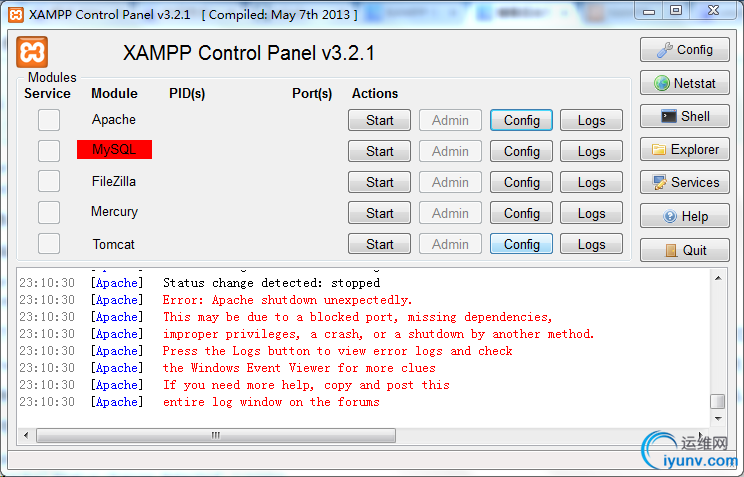

  今天重装xampp后,一直无法启动Apache,提示以下错误:
  22:36:54 [Apache] Attempting to start Apache app...
22:36:54  [Apache] Status change detected: running
22:36:55  [Apache] Status change detected: stopped
22:36:55  [Apache] Error: Apache shutdown unexpectedly.
22:36:55  [Apache] This may be due to a blocked port, missing dependencies,
22:36:55  [Apache] improper privileges, a crash, or a shutdown by another method.
22:36:55  [Apache] Press the Logs button to view error logs and check
22:36:55  [Apache] the Windows Event Viewer for more clues
22:36:55  [Apache] If you need more help, copy and post this
22:36:55  [Apache] entire log window on the forums

  啊哈,接下来可以重启Apache了,运气好的话,发现,还是端口被占用哦。
  23:10:29 [Apache] Attempting to start Apache app...
23:10:29  [Apache] Status change detected: running
23:10:30  [Apache] Status change detected: stopped
23:10:30  [Apache] Error: Apache shutdown unexpectedly.
23:10:30  [Apache] This may be due to a blocked port, missing dependencies,
23:10:30  [Apache] improper privileges, a crash, or a shutdown by another method.
23:10:30  [Apache] Press the Logs button to view error logs and check
23:10:30  [Apache] the Windows Event Viewer for more clues
23:10:30  [Apache] If you need more help, copy and post this
23:10:30  [Apache] entire log window on the forums
  Google了一下,发现,APACHE 还需要 443 端口,具体可以查看xampp/apache/conf/extra/httpd-ssl.conf文件,里面有个listen443,检查一下443端口的占用情况,又被占用了,一样的,将443改为444.
  如何找到上面两个文件,可以采取这样的方式。如下图,点击config,出现的前两个,便是了~
  重启Apache,OK,搞定,perfect!
