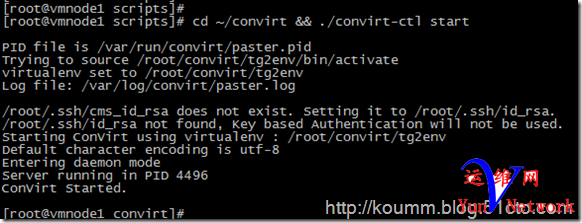

(7)启动与关闭convirtCMS启动convirt
关闭convirt
# /root/convirt/convirt-ctl stop

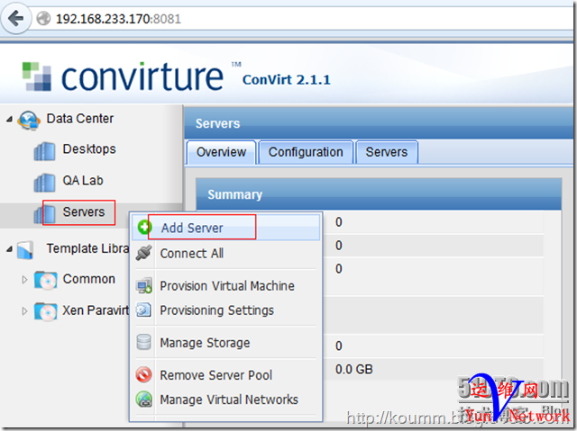

(8)打开convirt2.1.1http://192.168.233.170:8081
输入admin/admin
还需要在kvm虚拟主机上安装convirt-tools工具之后才能添加。

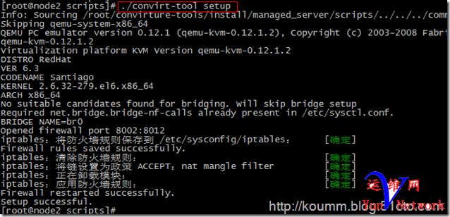

2.在KVM虚拟主机上安装convirt-tools工具
# wget http://www.convirture.com/downlo ... -tools-2.1.1.tar.gz# tar zxvf convirture-tools-2.1.1.tar.gz# cd convirture-tools/install/managed_server/scripts# ./convirt-tool install_dependencies# ./convirt-tool setup

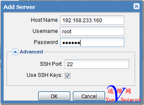

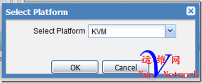

3.在convirtcms上添加KVM虚拟主机添加KVM虚拟主机。
