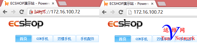

测试:
web4上停止httpd服务:
[iyunv@web4 ~]# service httpd stop
Stopping httpd:                                            [  OK  ]
https已不能访问(backend https-servers只定义了web4),但http仍能正常访问
ha2上haproxy安装完毕后

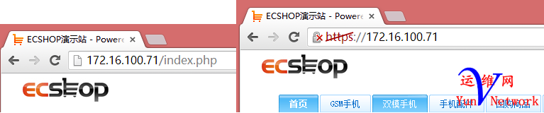

测试,

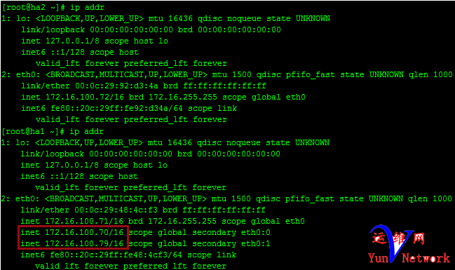

故障转移:
[iyunv@ha2 ~]# service haproxy stop
Shutting down haproxy:                                     [  OK  ]
vip漂到了ha1上
