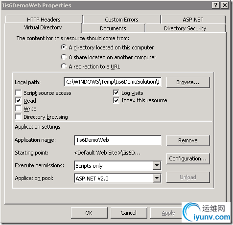

  For the rest of you, start by right clicking on the Virtual Application node (IIS6DemoWeb in this case) and select Properties. You should see the following dialog.
  Make sure you’re on the Virtual Directory tab and select Configuration. Note that you can also choose to make this change on the root website, in which case the tab you’re looking for is Home Directory not Virtual Directory.
  This will bring up the Application Configuration dialog which displays a list of ISAPI mappings. Scroll down to see if .mvc is in the list.
  In the screenshot, you can see that .mvc is in the list. If it is in the list on your machine, you can skip ahead to the next section. If it’s not in the list for you, let’s add it to the list. You’re going to need to know the path to the aspnet_isapi.dll first. On my machine, it is:

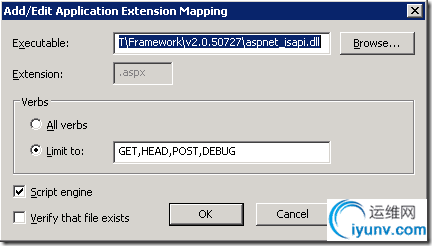

  It might differ on your machine. One easy way to find out is to find the .aspx extension in the list and double click it to bring up the mapping dialog.
  Now you can copy the path in the Executable text box to your clipboard. This is the path you’ll want to map .mvc to.
  Click Cancel to go back to the Application Configuration dialog and then click Add which will bring up an empty Add/Edit Application Extension Mapping dialog.
  Fill in the fields with the exact same values as you saw for .aspx, except the extension should be “.mvc” without the quotes. Click OK and you’re done with the mapping.

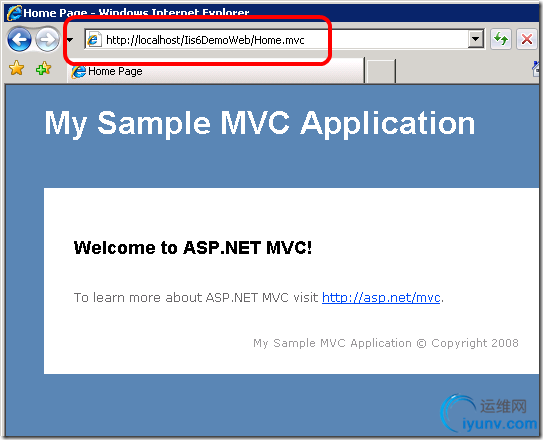

  Now, I can hit CTRL+F5 (or browse my website) and I should see the following home page.

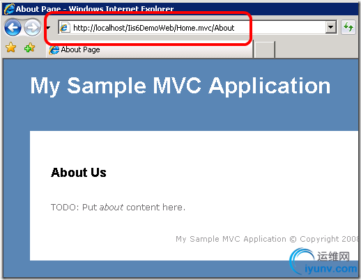

  And about page.
  Notice that the URLs contain the .mvc extension.

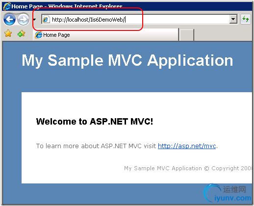

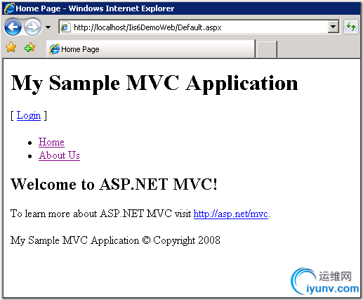

  Of course, you’re going to want to be able to navigate to the web root for your project. Notice what happens when you navigate to /Iis6DemoWeb.
  This is a bug in the Default.aspx.cs file included with our default template which I discovered as I was writing this walkthrough. We’ll fix it right away, but I can provide the fix here as it’s insanely easy.
  Note: If you received a File Not Found error when visiting the root, then you might not have Default.aspx mapped as a default document. Follow these steps to add Default.aspx as a default document.
  As I’ve written before, this file is necessary for IIS 6, IIS 7 Classic Mode, and pre SP1 Cassini, but not IIS 7 Integrated. So if you’re using Cassini with Visual Studio 2008 SP1 and deploying to IIS 7 Integrated, you can delete Default.aspx and its sub-files.
  In the meanwhile, the fix is to make the following change.
  Change:
HttpContext.Current.RewritePath(Request.ApplicationPath);  To
HttpContext.Current.RewritePath(Request.ApplicationPath, false);  If you created your website in the IIS root rather than a virtual application, you would never have noticed this issue. But in the virtual application, the URL to the stylesheet rendered contained the virtual application name, when it shouldn’t. Changing the second argument to false fixes this.

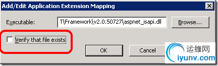

  This brings up the wildcard application mapping dialog. Enter the path to the aspnet_isapi.dll. You can follow the trick we mentioned earlier for getting this path.
  Don’t forget to uncheck the Verify that file exists checkbox! This is one of the most common mistakes people make.
  If you’ve been following along everything in this post, you’ll need to go back and reset the routes in your Global.asax.cs file to the default routes. You no longer need the .mvc file extension in the routes. At this point, you can also remove Default.aspx if you’d like. It’s not needed.
