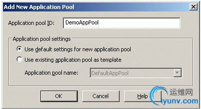

  To create a new application pool from scratch, right-click on the Application Pools node from the tree view and select New->Application Pool from the context menu. You will be presented with the following screen, where you need to enter a name for the application pool.
  When creating a new application, you also have the option of inheriting the settings from an existing application pool. For example, if you want your new application pool to inherit the settings from the DefaultAppPool, you can do that by selecting the option Use existing application pool as a template in the above screen. After you pick this option, the Application Pool name dropdown box will be enabled from where you can select an existing application pool.

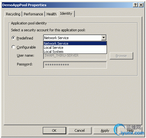

  To configure identity for an application pool, right-click the application pool and select Properties from the context menu. In the Properties dialog box, select the Identity tab and you will see the following screen.
  In the above dialog box, when you select the Predefined option, you can select any of the pre-defined accounts from the dropdown box. Instead of using a pre-defined account, if you want your application pool to run under a different account, select the Configurable option and then set the User name and Password in the textboxes. This approach is particularly useful especially when you are running multiple applications or sites on one Web server. For example, if an ISP hosts two companies—who may even be competitors—on one Web server, it has to guarantee that these two applications run in isolation from each other. More importantly, the ISP has to make sure that a malicious administrator for one application can't access the data of the other application. You can accomplish this level of isolation by using the configurable worker process identity.
