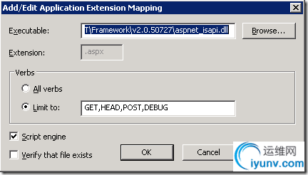

  It  might differ on your machine. One easy way to find out is to find the  .aspx extension in the list and double click it to bring up the mapping  dialog.
  Now you can copy the path in the Executable text box to your clipboard. This is the path you’ll want to map .mvc to.
  Click Cancel to go back to the Application Configuration dialog and then click Add which will bring up an empty Add/Edit Application Extension Mapping dialog.
  Fill in the fields with the exact same values as you saw for .aspx, except the extension should be “.mvc” without the quotes. Click OK and you’re done with the mapping.
