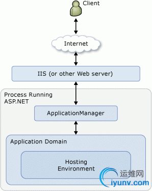

  ASP.NET receives the first request for the application.
  When ASP.NET receives the first request for any resource in an application, a class named ApplicationManager creates an application domain. Application domains provide isolation between applications for global variables and allow each application to be unloaded separately. Within an application domain, an instance of the class named HostingEnvironment is created, which provides access to information about the application such as the name of the folder where the application is stored.
  The following diagram illustrates this relationship:

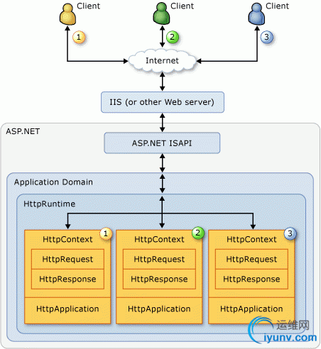

  ASP.NET core objects are created for each request.
  After the application domain has been created and the HostingEnvironment object instantiated, ASP.NET creates and initializes core objects such as HttpContext, HttpRequest, and HttpResponse. The HttpContext class contains objects that are specific to the current application request, such as the HttpRequest and HttpResponse objects. The HttpRequest object contains information about the current request, including cookies and browser information. The HttpResponse object contains the response that is sent to the client, including all rendered output and cookies.
  An HttpApplication object is assigned to the request
  After all core application objects have been initialized, the application is started by creating an instance of the HttpApplication class. If the application has a Global.asax file, ASP.NET instead creates an instance of the Global.asax class that is derived from the HttpApplication class and uses the derived class to represent the application.
Note:  The first time an ASP.NET page or process is requested in an application, a new instance of HttpApplication is created. However, to maximize performance, HttpApplication instances might be reused for multiple requests.
  When an instance of HttpApplication is created, any configured modules are also created. For instance, if the application is configured to do so, ASP.NET creates a SessionStateModule module. After all configured modules are created, the HttpApplication class's Init method is called.
