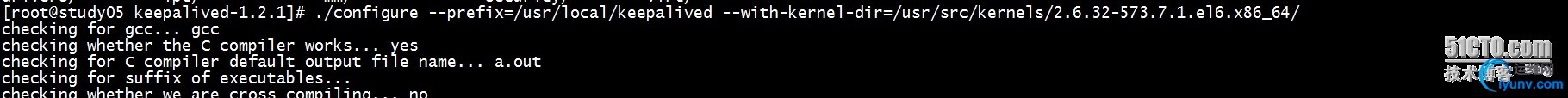

./configure --prefix=/usr/local/keepalived
       --with-kernel-dir=/usr/src/kernels/2.6.32-573.7.1.el6.x86_64/
在编译的时候会遇到一些问题

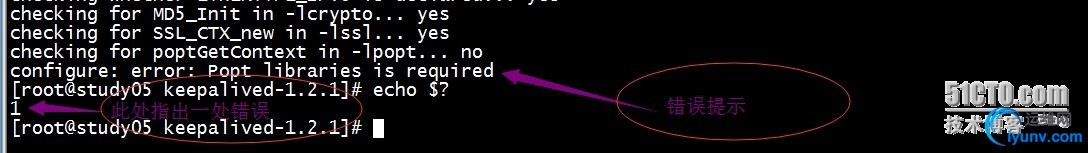

wKiom1YU0-6j03-8AAHaXnmBRCA818.jpg 说明缺少popt-devel 组件,安装此组件即可:
    yum -y install popt-devel

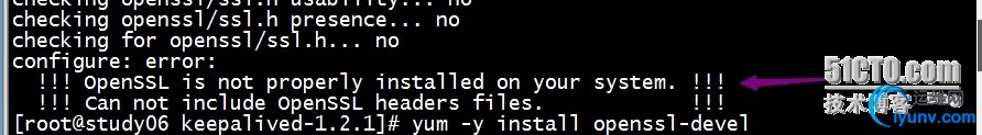

出现此提示,是缺少openssl-devel 组件,直接安装即可

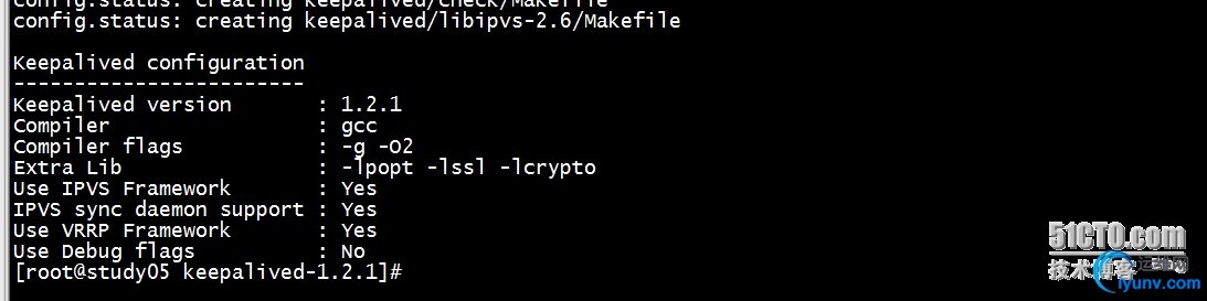

出现此界面,证编译成功

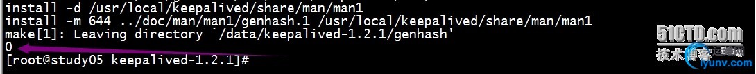

    make && make install ;echo $?
若返回0,即证明安装成功

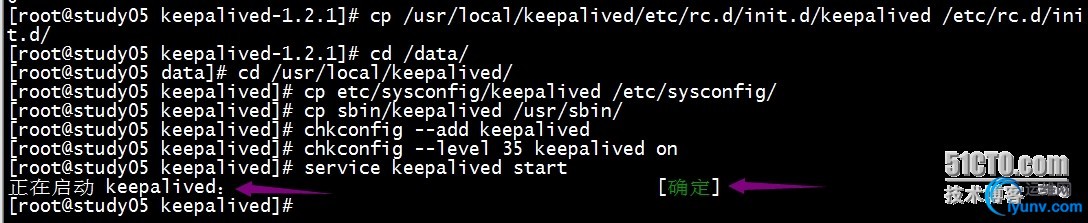

设置开机启动
    cp /usr/local/keepalived/etc/rc.d/init.d/keepalived     /etc/rc.d/init.d
    cp /usr/local/keepalived/etc/sysconfig/keepalived    /etc/sysconfig
    cp /usr/local/keepalived/sbin/keepalived        /usr/sbin
    chkconfig --add keepalived
    chkconfig --level 35 keepalived on
keepalived 安装成功
