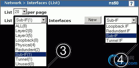

DSC0003.gif From the List Interfaces drop-down menu, select Sub-IF:
DSC0005.gif From the Interface drop-down menu, select Sub-IF:
DSC0006.gif Click New:

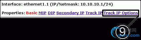

DSC00011.gif From the Sub-Interface, click Edit:
DSC00013.gif From Properties, click Track IP Options:

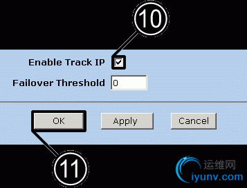

DSC00015.gif Select the Enable Track IP check box:
Click OK.
