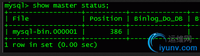

先查询mysql2的 状态
mysql> show master status;
File             mysql-bin.000001
Position     386
