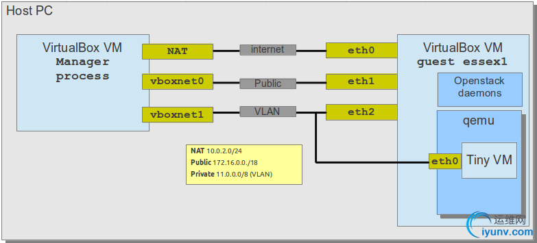

The best way to get an insight into OpenStack is playing with a live installation, but OpenStack's simplest configuration requires 2 network interfaces, e.g. 2 machines, each equipped with 2 network cards and an additional ethernet hub. Using VirtualBox we can set up a full OpenStack installation on a single laptop or desktop.

  Add host-only netwok for vboxnet0 – this will be the Public interface
  set IP to 172.16.0.254, mask 255.255.0.0, dhcp disbaled
  Add host-only netwok for vboxnet1 – this will be the Private (VLAN) interface
  set IP to 11.0.0.1, mask 255.0.0.0, dhcp disbaled

Network tab: see figure above
Adapter 1: attached to NAT – eth0 will connect here;
Adapter 2: attached to Host-Only Adapter, vboxnet0 - eth1 will connect here ;
Adapter 3: attached to Host-Only Adapter, vboxnet1 - eth2 will connect here;

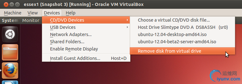

VirtualBox should popup a wizard to connect the ISO file as boot device.
Note: If this doesnt happen (e.g. this isn't your first attmept to boot the VM), you may use the Storage tab to hook the ISO to the virtual CD drive. Alternatively, use the VM window's Devices menu to do the same.

 when prompted to reboot, disconnect the ISO from the CD
