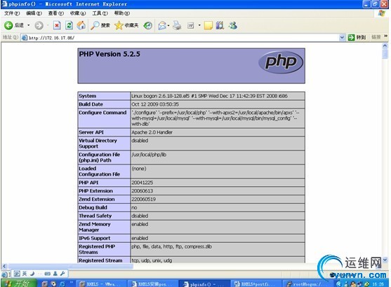

九、安装php(Php 解释器,与apache一起使用)
http://www.php.net
#tar jxvf php-5.2.5.tar.bz2 –C /usr/local/src
# mkdir -p /usr/local/php
# cd /usr/local/src/php-5.2.5
#./configure --prefix=/usr/local/php --with-apxs2=/usr/local/apache/bin/apxs --with-mysql=/usr/local/mysql --with-mysqli=/usr/local/mysql/bin/mysql_config --with-zlib
#make
#make install
#cp php.ini-dist /usr/local/php/lib/php.ini
#vim /etc/httpd/httpd.conf
修改以下内容(大约351行,添加后面两行,针对php支持)
AddType application/x-compress .Z
AddType application/x-gzip .gz .tgz
AddType application/x-httpd-php .php
AddType application/x-httpd-source .phps
(209行,将index.html改为index.php)
<IfModule dir_module>
DirectoryIndex index.php
</IfModule>
(147行,修改默认网站目录)
DocumentRoot "/var/www"
(174行,修改默认目录)
<Directory "/var/www">
#mkdir –p /var/www
#echo "<? phpinfo(); ?>" > /var/www/index.php
# /usr/local/apache/bin/apachectl restart
httpd: Syntax error on line 99 of /etc/httpd/httpd.conf: Cannot load /usr/local/apache/modules/libphp5.so into server: /usr/local/apache/modules/libphp5.so: cannot restore segment prot after reloc: Permission denied[f1]
#chcon -t texrel_shlib_t /usr/local/apache/modules/libphp5.so
客户端直接使用浏览器输入地址浏览即可(http://172.16.17.86
