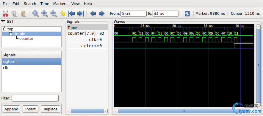

Now you should have a test.ghw wavefile in the current directory. Just look at it using the gtkwave command:
gtkwave test.ghw
and - oops, why don't I see a waveform? Well, you have to first select the desired signals from the tree view in the upper left pane (saying SST). Unlike isim, ghdl stores just all signals in the wave file, but compresses them well. You can save your current
view (byFile->Write Save File As) so you don't have to browse through your signals again. Next time, just append the name of your view file, like:
gtkwave test.ghw view.sav
Figure1.Simple example simulation displayed in GTKwave
