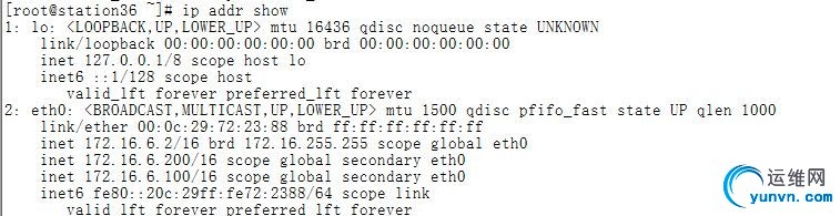

(3)启动Keepalived,Haproxy并测试,测试Keepalived高可用
Haproxy1 Haproxy2 启动Keepalived,Haproxy
[iyunv@localhost ~]# service keepalived start
[iyunv@localhost ~]# service haproxy start
对于Haproxy1,效果如下
对于Haproxy2,效果如下

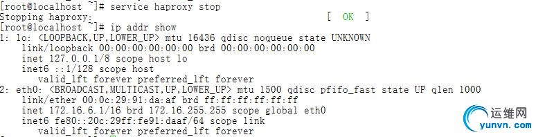

关闭Haproxy1的Haproxy服务测试,vip飘移

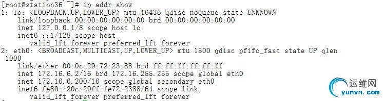

查看Haproxy2,接收到了Haproxy1飘过来的vip
