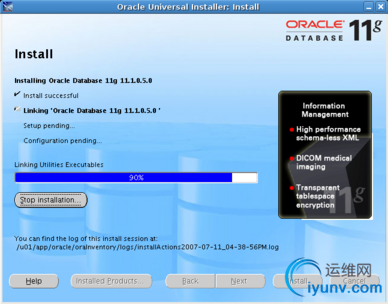

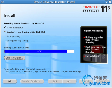

  Fire up the installer as the oracleuser itself.This is what you will probably see on the output window:
# su - oracle
$ cd /path/to/extracted/zip/file
$ ./runInstaller
Starting Oracle Universal Installer...
Checking Temp space: must be greater than 80 MB. Actual 58633 MB Passed
Checking swap space: must be greater than 150 MB. Actual 2900 MB Passed
Checking monitor: must be configured to display at least 256 colors. Actual 16777216 Passed
Preparing to launch Oracle Universal Installer from /tmp/OraInstall2007-07-11_04-38-56PM. Please wait ...
Oracle Universal Installer, Version 11.1.0.2.0 Production
Copyright (C) 1999, 2007, Oracle. All rights reserved.
ulimit: 1: Illegal option -u
rpm: To install rpm packages on Debian systems, use alien. See README.Debian.
error: cannot open Packages index using db3 - No such file or directory (2)
error: cannot open Packages database in /var/lib/rpm
  There are a few errors that can be safely ignored: the ulimitand the RPM-related errors, since the limits don’t restrict the installer and since we actually don’t have a RPM database on the machine — we are running on Ubuntu, remember?

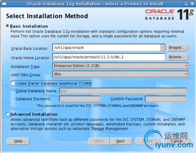

  After a few moments, you will be prompted to choose where to install the Oracle server. You’ll notice that I asked the installer to not create a starter database — I did that later. Choose the Oracle Base and correct the group if needed. I personally recommend sticking with the defaults if you are a newbie like me.

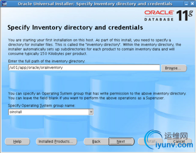

  As you press the Nextbutton, you will be prompted where to install the Inventory — leave it that wayunless you know what you are doing (if this were the case, you wouldn’t be reading this text anyways). Also correct the OS group name if needed and hit Next

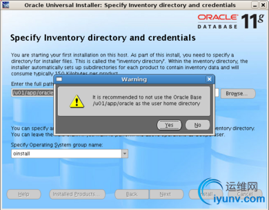

  Since I’ve chosen to install the server in the same directory as the oracleuser’s HOMEdirectory, the installer will issue a warning. I simply ignored it and continued with the installation.

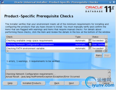

  After that warning, I tried to perform some prerequisite tests, and yes — some will fail. Just mark the failed boxes and hit Next(after trying a few times to fix those issues, I’ve decided to call the installer’s bluff and… it worked!)
  Note:
  Ignore some filures and warnings by making the check box checked and click next.

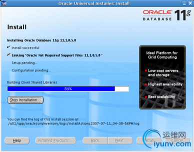

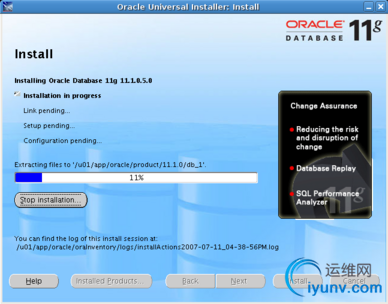

  After all this warning stuff, it’ll ask you to check the list of products to be installed. I was amazed when I read that 122 different products would be installed on my box. Hit Next
  Go get some coffee.
  And some more coffee.
  And even more coffee.
  You may like to go to the washroom after so much time drinking coffee. Remember: I was installing on a 3 GHz machine with 1 GiB of RAM with SATA2 disks — this box is supposed be blazing fast.

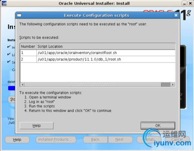

  At some point, it will ask you to run some commands as root
. Do that when it asks, since the install depends on a few modifications on the base system (like creating the /etc/oratabfile).
$ sudo -s
Password:
# /opt/oracle/oraInventory/orainstRoot.sh
Changing permissions of /opt/oracle/oraInventory to 770.
Changing groupname of /opt/oracle/oraInventory to oinstall.
The execution of the script is complete
# /opt/oracle/product/11.1.0/db_1/root.sh
Running Oracle 11g root.sh script...
The following environment variables are set as:
ORACLE_OWNER= oracle
ORACLE_HOME= /opt/oracle/product/11.1.0/db_1
[: 185: ==: unexpected operator
[: 189: ==: unexpected operator
Copying dbhome to /usr/local/bin ...
Copying oraenv to /usr/local/bin ...
Copying coraenv to /usr/local/bin ...
Creating /etc/oratab file...
Entries will be added to the /etc/oratab file as needed by
Database Configuration Assistant when a database is created
Finished running generic part of root.sh script.
Now product-specific root actions will be performed.
Finished product-specific root actions.

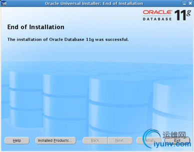

  After these scripts finish their execution (the errors seem to be ignorable), hit the OK button and you’ll have a window that (probably) will look like this one:
  Just hit OK to get out the installer. The basic installation is… not over yet.
