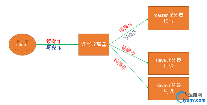

读写分离简单拓扑:
注意:在实际生产环境中,应该将写操作都发往master服务器,将读操作负载调度到slave服务器。
使用msyql-proxy实现读写分离:

[mysql-proxy]                                                           #全局配置段
daemon = true                                                           #以守护进程方式运行
pid-file = /var/run/mysql-proxy.pid                                     #进程PID文件路径
log-file = /var/log/mysql-proxy.log                                     #日志路径
log-level = debug                                                       #日志级别
max-open-files = 1024
plugins = admin,proxy
user = mysql-proxy
#Proxy Configuration                                                    #代理配置段
proxy-address = 192.168.43.111:3306                                     #代理地址,即为本机地址
proxy-backend-addresses = 192.168.43.113:3306                           #可读写后端主机
proxy-read-only-backend-addresses = 192.168.43.110:3306                 #只读后端主机
proxy-lua-script = /usr/lib64/mysql-proxy/lua/rw-splitting.lua          #脚本,指向读写分离脚本(rw-splitting.lua)实现读写分离
#proxy-skip-profiling = true                                            #禁用profile
# Admin Configuration                                                   #管理配置段
admin-address = 192.168.43.111:4041                                     #管理地址和端口
admin-lua-script = /usr/lib64/mysql-proxy/lua/admin.lua                 #使用的管理脚本为admin.lua
admin-username = admin                                                  #管理用户
admin-password = admin                                                  #管理密码
4.启动服务,测试
# mysql -uadmin -padmin -P4041 -h192.168.43.111
Welcome to the MySQL monitor.  Commands end with ; or \g.
Your MySQL connection id is 1
Server version: 5.0.99-agent-admin
Copyright (c) 2000, 2013, Oracle and/or its affiliates. All rights reserved.
Oracle is a registered trademark of Oracle Corporation and/or its
affiliates. Other names may be trademarks of their respective
owners.
Type 'help;' or '\h' for help. Type '\c' to clear the current input statement.
查看后端主机状态:
mysql> select * from backends;
| backend_ndx | address             | state   | type | uuid | connected_clients |
|           1 | 192.168.43.113:3306 | up      | rw   | NULL |                 0 |
|           2 | 192.168.43.110:3306 | unknown | ro   | NULL |                 0 |
#此时还没有读请求发送到只读后端,所以为uknown,执行几次下方的读请求语句再查看;
# mysql -uadmin -h192.168.43.111 -padmin -e 'select * from mysql.user;'
再次查看后端主机状态:
|           2 | 192.168.43.110:3306 | up    | ro   | NULL |                 0 |
#可以看到,已经up起来;并且从type可以看出来,一个为读写,一个为只读。
