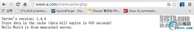

前端用户的请求发往nginx如果是请求动态内容时才会发往后端的php服务器,所以在站点的根目录下创建一个.php结尾的测试文件memcache,添加如下内容为:
10
     $mem = new Memcache;
    $mem->connect("172.16.103.2",11211) or die("Could not connect");
    $version = $mem->getVersion();
    echo "Server's version: ".$version."
    $mem->set('hellokey','Hello World', 0, 600) or die("Failed to save data at the memcached server");
    echo "Store data in the cache (data will expire in 600 seconds)
    $get_result = $mem->get('hellokey');
    echo "$get_result is from memcached server.";
这是一个测试连接memcached的php程序,连接成功时,会在memcached中插入hellokey这个键值及其数据。在浏览器内输入www.a.com/memcache.php
